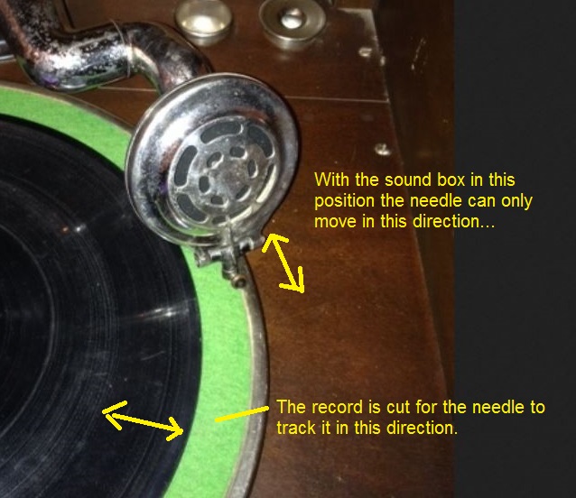

Thank you for taking the time to respond. I am attaching a couple of pictures (currently no needle in picture). Perhaps it's not the "gasket" then. I guess I will start with replacing the needle. I just thought the arm was too low to the record and weighed too heavy on the record. Thank you again for your comments.
Re: Gasket for Silvertone Tru-phonic Phonograph
by Joe_DS » Tue Nov 04, 2014 6:04 am
I can see what the problem is right away.
The sound box is in the wrong position for playing a standard (lateral type) 78 record. It is positioned so the diaphragm faces the front instead of the side. This type of arrangement was used for playing Pathe' records in which the groove was modulated up and down (or vertically).
Most 78s you'll come across were recorded with a lateral cut groove, in which the groove is modulated back and forth, or sideways.
This is the correct position for the sound box when playing these records:

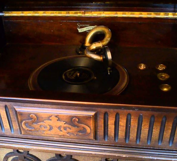

Video showing this player -- http://www.youtube.com/watch?v=jadoZCGOE2s
The way it is now, the needle is just scraping against the groove and wearing it out, without moving the diaphragm. (There might be some sound, but not much.)
Using your photo, above, here's an illustration of what I'm talking about:
I suspect that somewhere along the way the tonearm was replaced or perhaps broken and repaired. It's also possible that some type of adapter or extension was originally fitted to the tonearm for playing lateral cut records. (The earlier Sears phonographs produced prior to 1926 had a different type of tonearm which was designed to play both lateral and vertical cut records, using an adapter for each type. )

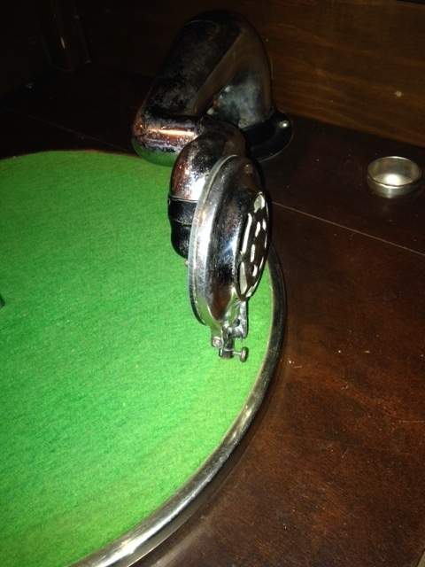

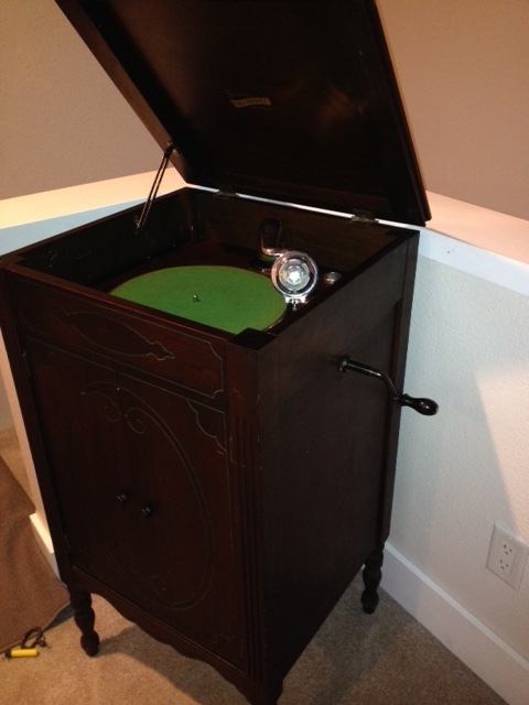

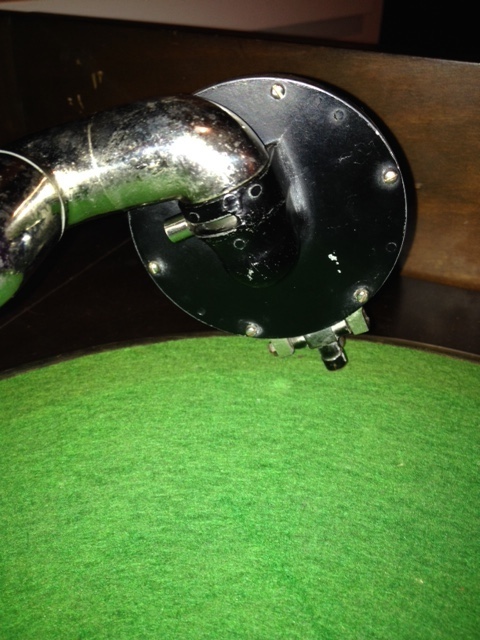

Here are a couple more pictures. I hope this shows a little better on how the reproducer can rotate.
by Joe_DS » Fri Nov 07, 2014 5:30 am
Hi Melanie:
Many, many thanks for posting those photos! Your model looks to be all original, so it confirms that the "universal style tonearm" designed to play both lateral and vertical cut records WAS fitted to some of the Tru-Phonic phonographs (sold exclusively by Sears). I had asked about this on other forums, over the years, and either never got a response or was told that no information is available, etc.
