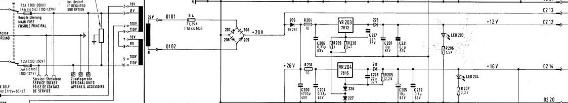

Thanks Ron. Not sure if this helps or not. This is the circuit or section of, that the resistor blew in.
Am trying to figure out/picture what you mean when you say if fuse on primary or secondary, sorry. :oops: To test, am I replacing the resistor, putting in proper fuse, and hooking it up to main power?

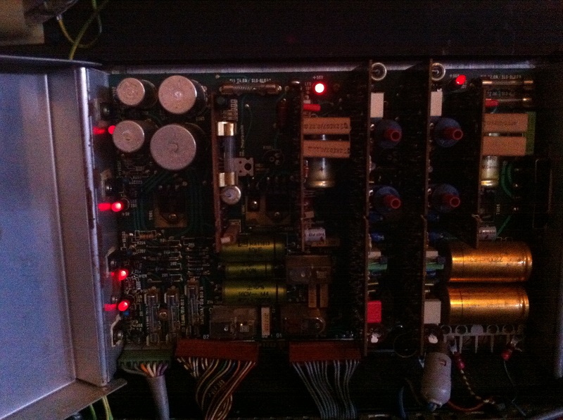

Thank you. Yes, schematics are not readily available. The above picture shows the particular portion of this circuit, and the R204 resistor in question. It could be a transistor, VR203 is next in line from R204 resistor. I had this pic in another post, the white fuse (was found to be bad) is the one that I had put a 2amp fuse in, instead of 1amp fuse. The diodes above it (206-209) are first past this fuse, followed by R204 resistor that fried, then the VR203 transistor.
