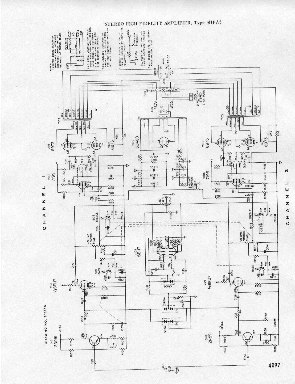

Hi, I am going to attempt to recap a shfa5 seeburg amp. Just wanted to double check something before I started. I understand the amp unlike the selector receiver is negative ground. If I run capacitors to ground from a b+ voltage, the negative lead of cap will be toward chassis ground. If I run a cap to ground from a b- voltage such as the negative voltages created by cr101, I put the positive lead of capacitor to ground correct? If I have that correct, any other tips you might suggest for this project?

I do not have the schematic handy today, but I do recall that the filter (cans) are NOT positive ground--
I think the AVC supply may be--just check the schematic, and put 'em in, the same way the old ones come out.
Also--change CR-1--use a 1N4004-- Ron Rich

Ron-Joe the only electrolytic's that re positive-ground are the bias and preamp filters. In addition to Ron's advice about replacing CR102 which is the AGC rect, you may need to replace CR103&104 to get good AGC action and channel balance. As in the transistor amps these are selenium rects but unlike CR102, you'll need to replace each diode depicted in the symbol with -two diodes in series- to compensate for modern diodes' lower internal resistance.
PS: here is a schematic from Vern Tisdale's site: http://www.verntisdale.com/schem/shfa5.jpg

Thanks for the response guys. Rob I'm sorry to be a bone head, but I really don't want to make a mistake and fry something. The schematic resolution isn't good enough for an old geezer like me to make out the polarity signs at the main power supply. You refer to positive ground for preamp filter cap and bias voltage cap. Isn't that the negative voltage created by cr101 in the main power supply that I refereed to? I believe cr101 creates -33 volts for bias and -30 volts for the preamp supply. Since -33 and -30 are more negative than the chassis, shouldn't the caps have negative leads toward the -33 and -30 volts and positive toward chassis? I'm sorry for asking again, but I don't want to see any smoke.

"Positive-ground" means that the positive end of the cap goes to chassis (or other) ground. You are correct. The high voltage B+ caps are conventional negative ground.
