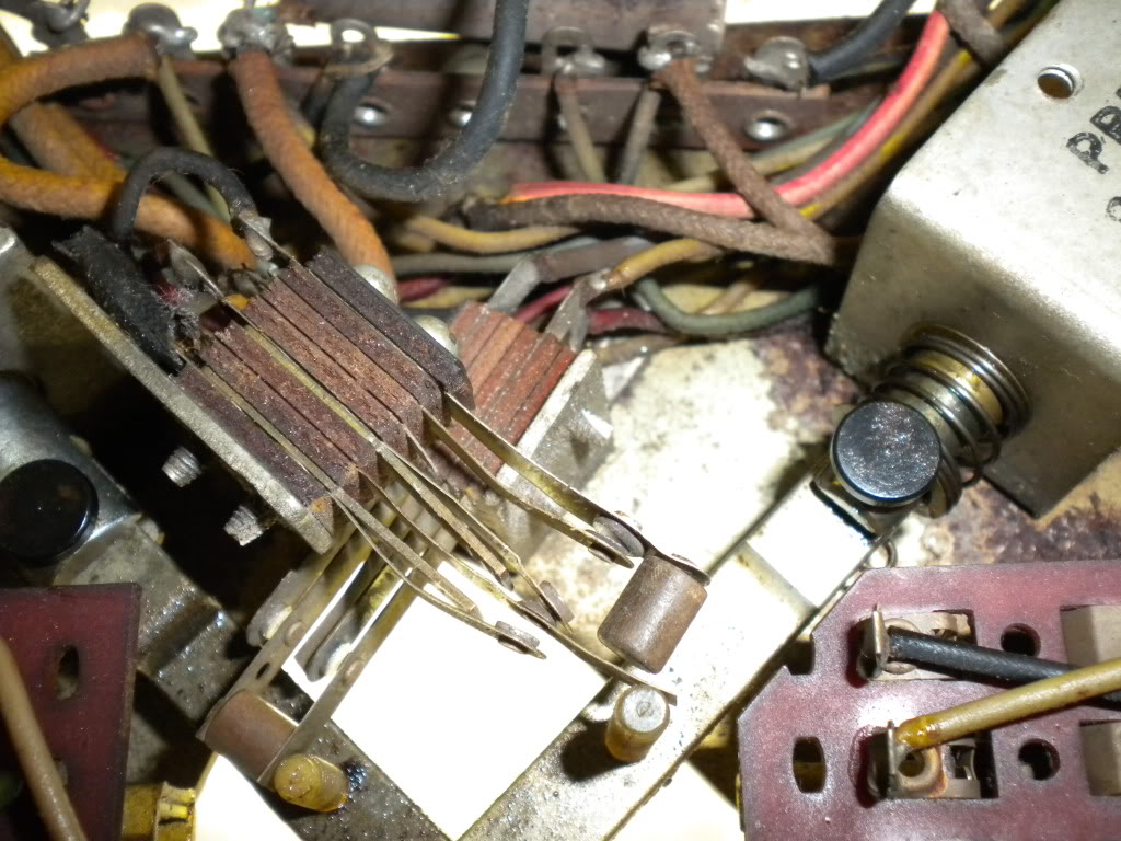

Hello, My names Danny, and I'm a new guy. I joined up to this site hoping that there would be some juke techs out there that could help me in my restoration of my 1963 Wurly 2710. So nice to meet you! I do have an immediate question but I will fill in the story up to this point. I got the jukebox in 2001 gutted it, cleaned up and adjusted all the mech components as much as I could (per the factory shop manual) put everything back together. Worked great. The juke is rigged for free play, how I do not know becuase half of the coin mech is gone. The select light had always stayed lit and you could select a song and it would play, etc. So about 8 months ago the selector mech would start to "stick" every few songs. Over time it got worse but you could slap the top of the selector panel and it would go. last month it stopped completely (no select light, buttons locking , nothing) So I did some looking and I discovered that the contacts for the control switch where corroded so I cleaned them with a ultra fine emery board. and thought that would do it. Nothing, so I read some more and well you could adjust the actually selector switch. So I did that and nothing. Then fianlly I saw that on set of contacts weren't touching so I had to "adjust" them so they touched. It looks like the control switch has 2 sets plus one solo contacts, the two sets looks like there would susposed to be normally closed and the lone contact would to connected when you would select a song, (I assume to reset the pre-set solenoid)

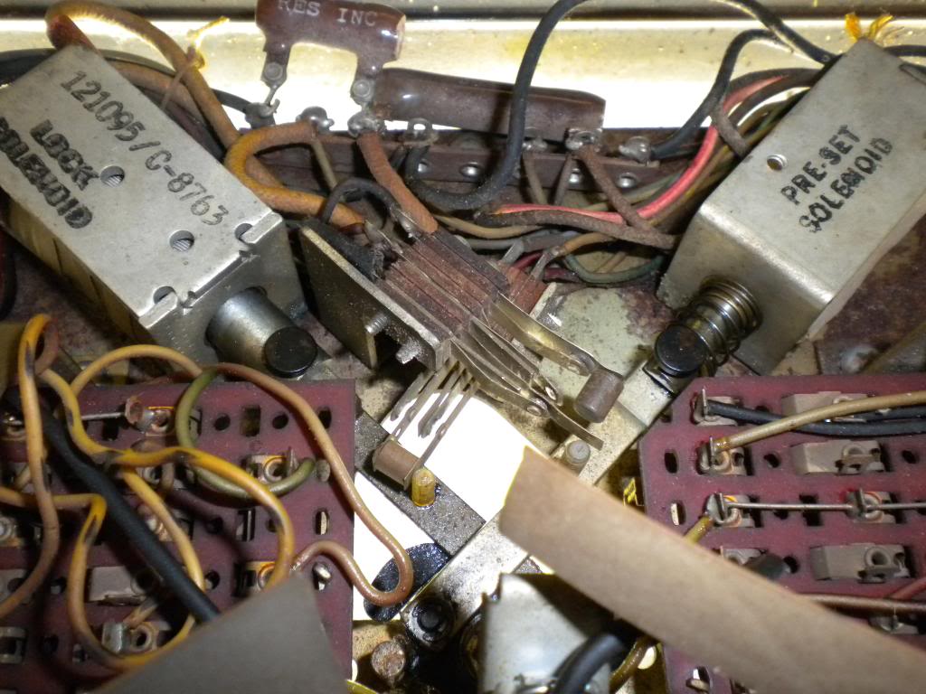

My big problem now is The selector mech works again just like it used to, but now after you select a song the Pre Set Solenoid plunger goes down and engages (ready for a person to select the next song) and gets hot and RED Hot. you can smell it and see it get hot. So the only way I can stop this is to undo my adjustments so the the selector mech doesn't engage. I really need to know what I'm doing wrong or if someone has a pic of this area with the contact switch on a functional mach so I can see how it's originally suppose to look ( My shop manual pic is crap and I can't see the contacts clearly. I will include a pic of MY control switch so you all can see what I'm talking about. I would assume a 24,25,26 or 28oo series wurly juke would have a pretty close setup to this as well. So ANY help would be greatly appreciated

Unfortunately, the 2700 keyboard was the worst one WurliTzer ever used. It is unlike any other model, in that the others do not have the "pre-select" coil.
I don't have the schematic handy, but I think that there should be a large resistor in series with that coil. It may, or may not be "added in" via a switch. Check out the schematic, and be sure that the switch, if used, is operating correctly. As for the pix, it looks like you have the contacts fairly well adjusted, however the contact points should "come together" more evenly (ie. "flat"- up against each other). Would need to see a photo of them with the power off to be sure. One other thing--"emery board" is not recommended for contact cleaning--use a "Burnishing Tool"-- Ron Rich

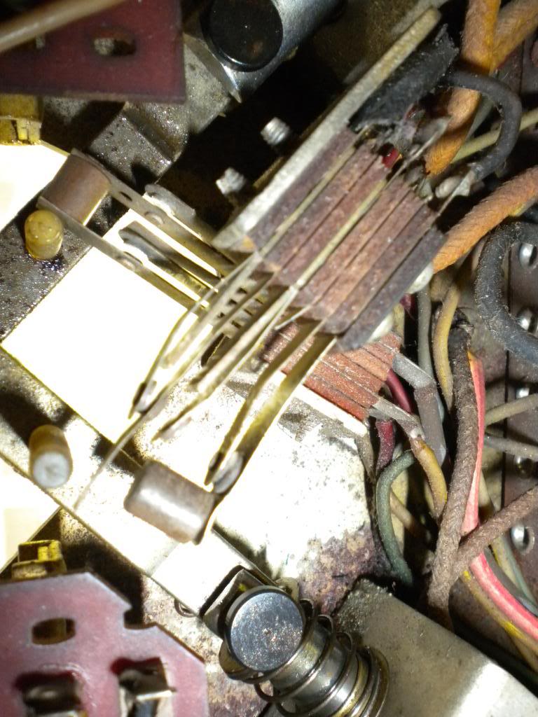

Those pics are with the power off. Are the control switch contacts (The bent up ones) supposed to be open and NOT closed with no power? That's the only way I can get the select light to light and the mechanism to play a record and then reset for the next selection is having the contacts closed. I'm also not very good at reading schematics, I can do adjustments, etc... but not schematics, I do have them though. If I scanned and posted them would that help? ( Anyone out there who can read them I guess.)
Also Here's what it looks like powered up.

---IF-- that solenoid is relaxed, with the plunger extended, You need to un-plug that phonograph now, and leave it un-plugged before you cause more harm. Those "blades" look like they will suffer no more "adjusting". Then you need to find someone with more knowledge of how switches work to help you. It also appears (this maybe due to photo angle) that one of the silver contact points is worn beyond it's useful life, and needs replacement. I strongly suggest that you find a "pro" in your area to help--- Ron Rich

To me both of those leaf switches need work or replacing, you can strip them down and replace any of the leaf's so you get a good contact. We normally clean these in operation with a paper taper of fibre glass pencil to just hone the silver tips but yours are past redemption.

Ron the contact blades and silver points are what I need replaced , as you can see from the pictures above they are shot, I am surprised that I got them even working as well as they do right now.
