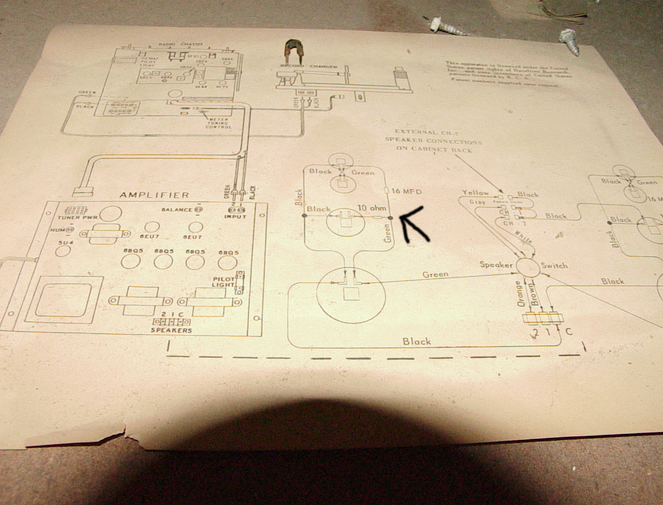

(229.09 KiB) Not downloaded yet
dont know where to post this but i need speaker help (i dont know anything about speakers)
ok i have a Technics SA-290 Receiver that can take 8-16 ohm speakers. i have CD and photo hooked up to it i pulled speakers from old cabinet stereo i believe there are 10 Ohm due to something that looks like small M-80 fire work guessing a cross over that says 10 ohm on the schematic in old cabinet stereo. Each side has 4 speakers 1-15 inch woofer 1-6 inch mid-range and 2-4 inch tweeter i would like to get a sub woofer but only ones i can find are 8 ohm can i mix 8 ohm sub with 10 ohm speakers? if not does anyone who where to get 10 ohm sub?

Going by that diagram, those are all 4 ohm speakers in a magnavox console.

The 10 ohm "firecracker" is a resistor used to pad down the midrange speaker.

MattTech wrote:Going by that diagram, those are all 4 ohm speakers in a magnavox console.
i dont want this to come off wrong
but how can you tell??

by MattTech » Sat Jun 09, 2012 6:34 pm
As a long time service technician, and knowing Magnavox consoles the way I do, from experience is how I know.
I hope that answers your question.
Hint: observe my location information to the right--------->
