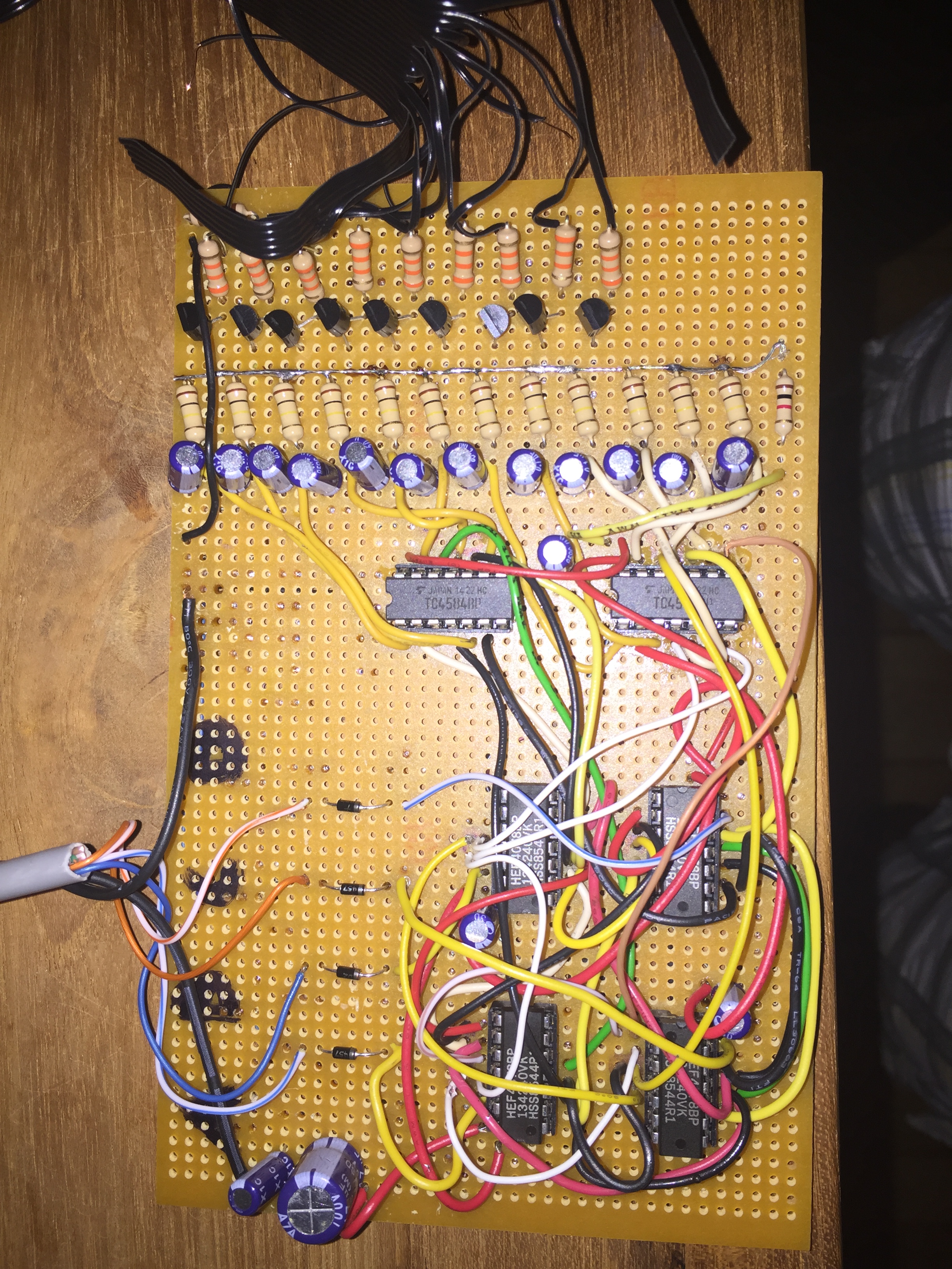

Hello everyone,
Is there an solution to connect the J2 connector on the MCU to an Raspberry Pi?
I want to program a hosted site on the Raspberry Pi, where you can choose for your selection.
I want to make it compatible with mobile devices, so you can choose your music from your chair.
The J2 on the MCU is by default for the translator to control the SMC with an consolette.
Please let me know if you know something.
With kind regards,
Mike de Bruin

Thanks for your reply. But what I want to send to the j2 connector on the mcu is only the selecton number. Not music, becouse the mcu duos noting with that.
But I saw that it used 4 data lines with 12v pulses but I need more details About that to create an script to let them made the selection.

by Catweazle0172 » Sat Jun 18, 2016 6:44 pm
Hi All,
Here is an video of the remote working control:
https://youtu.be/7WNbR0eqMfE
I recreated the keyboard, and controlled this with an Raspberry pi with an website running on it.
