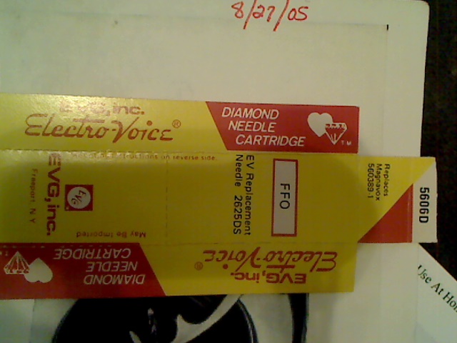

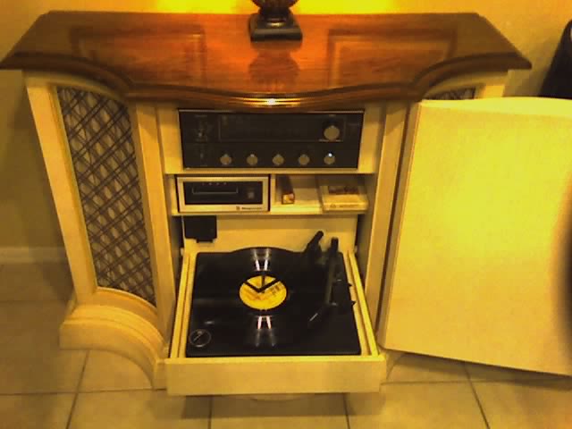

by Bobby Basham » Wed May 11, 2016 10:18 pm
I have a circa 1974 credenza stereo with a new W716 turntable that has a replacement cartridge. The previous owner actually left the little case. The needle does not drag, but the brush definitely doesn't touch the record. It fits the same way as the original poster's cartridge but the needle does not drag. I don't know the relationship, if any, between Tetrad and EV, but my labeling says Electro Voice. --BB
Picture 48.jpg (80.15 KiB) Viewed 229 times
