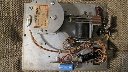

My accumulator only has one coil and a which controls a ratcheting device that counts credits? Are the coils you mention supposed to be in the accumulator or are they someplace else?
I also had the accumulator sent out a year or so ago and I was told it was working properly? (that was when I first started working on this problem).

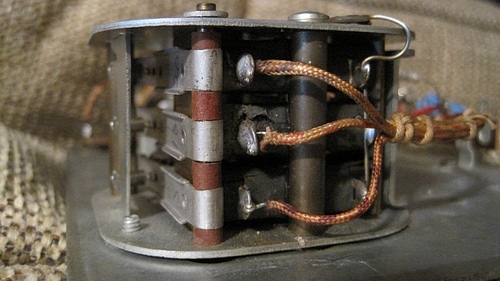

How does the acc "add credits" ? I think you are seeing the "subtract coil" --unless this still used a mechanical "arm" to add credits ( I do not recall the year that R/O changed over), there should be three small "Add coils" hidden under the assembly--

Yea, you are right. I did find those coils you were talking about (see pic). I guess there is no way to test them is there?
Well I still have to find out why the 1/10th amp keep blowing first anyways. Maybe if I'm really lucky when I fix the short I'll find out that the credit windings are ok.

Accumulator

A burnt credit add coil-or two burnt coils, or three burnt coils--depends on how many times the wrong fuse was installed, and how many times someone attempted to add credits, using their fingers on the credit switch(es) --one or more of which was, and may still be "shorted". Ron Rich
