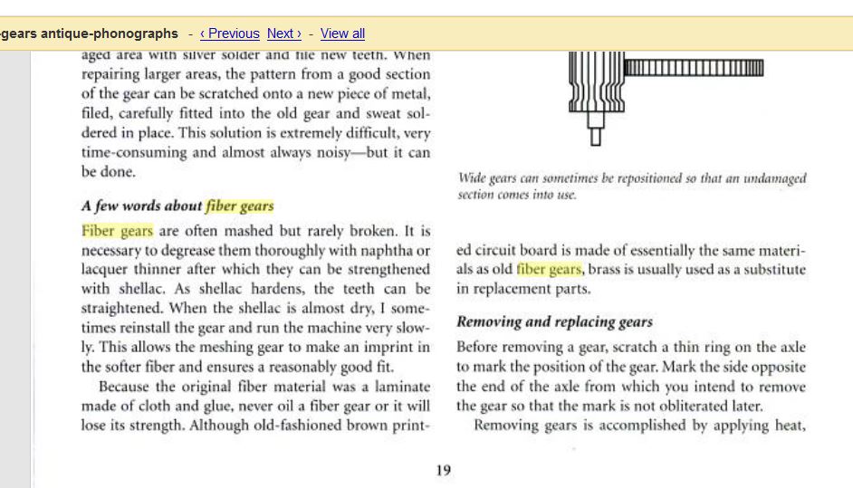

I'm not sure if the gears used in the 1920s to early 1950s wind-up portables were different than those used in electric motors. I do know that I used oil on one of the gears of a Birch portable, circa late 1930s, I owned. After about a year, the gear started to separate. I think it was a laminate material, made from cloth and glue, as explained here --
http://books.google.com/books?id=hVTcbL ... hs&f=false
It's possible that molly graph is viscous enough not to saturate the gear. I've used dry graphite on fiber gears, or have left them be un-lubed just to play safe.
