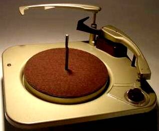

I can solve this. Look at the record changer in the console. If it is the original changer made in 1949, then it would look like this. Note the curved spindle and the record pusher post on the Webster-Chicago 356 (the first 3-speed record changer ever built). It might also have an upgraded 2-speed Webster-Chicago 256 that looks similar, but has the speed control on the left back corner.
The tonearm might look different (mine from 1949 has an unusual looking arm with the cartridge in a vertical cylinder formed in the Bakelite arm). And it is not stereo.

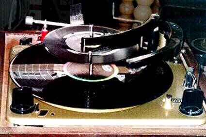

A drop-in stereo replacement turntable (that fits the cutout in the mounting board) made by Webcor (the renamed Webster-Chicago) might have looked like this:

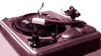

If the console originally came from 1960 or 1961, the changer should look like the one in my avatar, which came from such a console. Here is a bigger version of the Collaro Conquest TSC-640:
Note that the turntable mat, the cue control, the autospeed index arm, and several attachments on mine are not original equipment.
Magnavox switched to Collaro changers in 1955.
