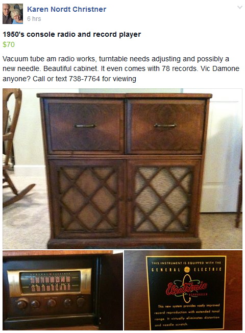

I need some help, I bought a GE Console Record/Radio Player but it only plays 78rpm at the right speed. I've heard there is a way to change the speed to that it plays the larger records that I have (LPs) such as a switch on the back but I cant seem to find it. Am I SOL to play my colllection of LPs on this player or is there a way to change the speed.
HELP! I've included a picture the record console I purchased

Unfortunately, your purchase didn't include inspecting the unit to determine if it played LP's.
That said, that unit will only play 78's, and was made before 1950, when LP's were first introduced.
Also, that system will require a mandatory overhaul/restoration if you want to use it, otherwise it's a ticking time bomb and unsafe to plug in, even IF it apparently "works" now.
Trust me, I know, I'm a restoration tech and have seen these come into the shop many times - fried, due to people not knowing the risks.
However, these CAN be retrofitted with a multi-speed changer of appropriate vintage, if done properly, along with the electronic servicing.
I've done that too for people.

Is that a model 326? (See: http://www.radiomuseum.org/r/general_el_326.html )
Another option, after the electronics have been completely overhauled, is to keep the original turntable in place, but install an adapter (not sure what it's called; windup phonographs are my focus) that would allow a more modern turntable to be hooked into the amplifier. You could simply set the turntable on top of the cabinet. If you opt for a complete replacement, make sure you save the original turntable & components. Not that this has--or ever will have--any great value as an "antique," but it IS about 70 years old, and it's made it this far without being butchered or turned into a liquor cabinet, so it would be a shame to toss the original components at this point.
I don't know what era your LPs are from, but if they are stereo from the later-1960s--onward, installing an older style (refurbished) 3-speed turntable (appropriate for the cabinet) that was designed for (pre-stereo) monaural playback might not work. It would likely chew your records up. And if you use a more modern turntable, equipped with a stylus and lightweight tonearm designed for stereo records, you'll still only get monaural reproduction.
I think if I were in your position, I'd re-sell it and look for something more modern, considering the money you'll have to invest. (Just my two cents, of course...) There are plenty of high quality late 1960s & 1970s console units for sale on Craigslist, for next to nothing. Of course, even something from that era will still need to be inspected to see if the electronics and mechanical parts need overhauling.

I agree with Joe. Don't butcher it up. Sell it and get something designed to play what you want to play or find a decent stand-alone changer that is meant for LPs , stereo or otherwise. There is a bit of a learning curve with records so do your homework before you purchase something else you cannot use. You can always ask us if you're not sure. Something else to consider. As Matt said, these vintage pieces will need a thorough restoration if they are ever to work properly. When you read " Works, just needs some oil and a new needle", pay no attention. It will need restored. Un-restored sets can be dangerous.
