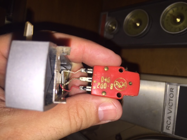

I just acquired an RCA PVCR-84 myself. It is in great condition. The am/fm radio works great. The turntable needs some work though. The needle was broken off of the phono cart so I ordered a new RCA 200-9 phono cart from VM-audio enthusiasts (waiting for it to arrive).

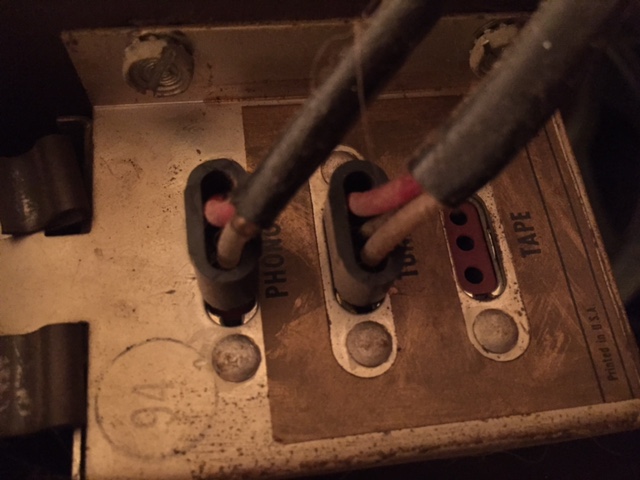

I am working on building a connector for the open tape input in the back. I moved the tuner input connector over to the tape slot and it worked fine if I changed the input knob to tape. I then spliced an old stereo cable for an ipod and connected the left and right wires to the outside pins of the tape input. It worked! I was able to play music from my iphone. The wires wouldn't stay though so I need to figure out a connector that I can use. I am going to go to an RC hobby shop tomorrow to see if I can find something that will work.
