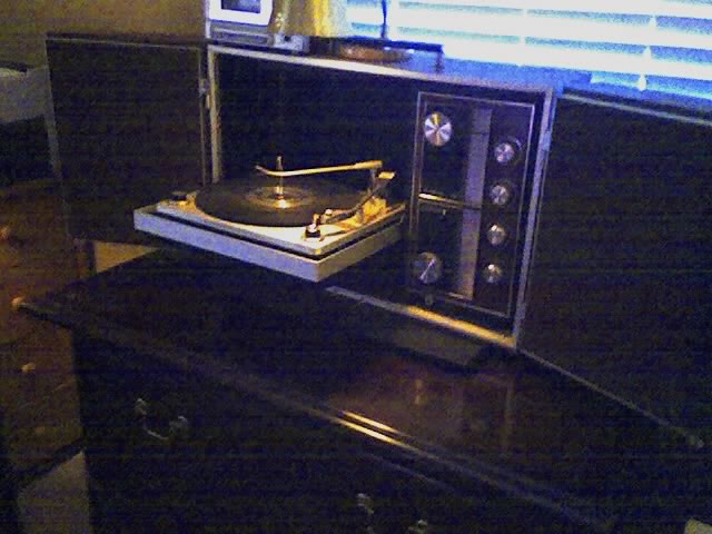

Hello everyone,
I'm new to this site and just joined last month. A friend of ours was moving and gave us a Magnavox Astro Sonic Console, model number 1ST693. This Maggie is awesome, and we love it, we are in the process of cleaning her up and restoring her to her formal glory. She a big girl, about 6ft long, has 15in speakers, and has a remote for a power tuner, which trys to work but needs to be cleaned and re-strung. When we got her home I opened the back and blew all of the years of dust out of her and cleaned her up a bite. After that we pluged her in and she worked great and sounded great. I replaced and re-soldered the wires on the needle and it worked fine after that. The problem we have now is that the right speaker doesnt work anymore and when you turn the balance know to the speaker, we get nothing. Only the left bank speaker is working. I've been reading a lot on this site about Maggie re-caps and was wanting to see what everyone thinks on here about what could be wrong.
I could also use some help as to were to start.
Jamie

Check all your wire connections before tearing into the thing. I removed an amp/receiver from an old Astro-Sonic. Even built its own case to give it that "component look" to use with some external components. One channel went dead, and I thought..."I'm not in the mood do do any cap jobs right now." One of my wires was bad, so problem solved. I do plan on recapping the thing anyway, but it works wonderfully and is at the bottom of my list.
I do have a couple of consoles acting alittle strange, but I'll check all the wiring first before ripping out tuners and amps. Remember, these Astro-Sonics were the crossover in the early 60's to solid-state, so we're looking at some old caps that will eventually fail.
Some of the early consoles had the balance control right on the chassis (inside the cabinet), while some, like the Astro-Sonic 100's, had a separate tuner with the balance control on the face plate
Check all you wires first before going on to major surgery. Reverse the wires to see if the sound transfers to the other channel. See if your radio and any external sources are playing through both channels. Do a process of elimination. I got one Maggie here with the same issue, and hoping it just may be a bad wire/connection. --BB

I tried switching the channels already, and the right bank works fine when I switch them. So I think this old gal needs a re-cap done. I just dont know where to start or what to look for. Do you know any sites or books that would help me out? Oh forgot to mention that this is a 1964 model.
