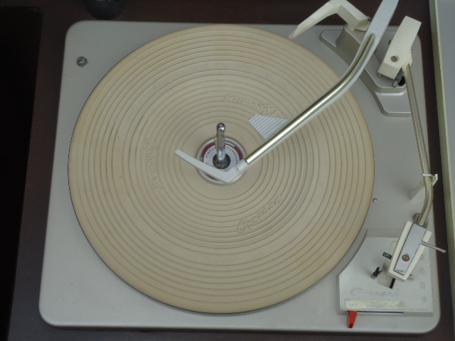

Hi, I just purchased the same stereo.... I also need a needle for my record player... could you suggest what type and where to buy one?

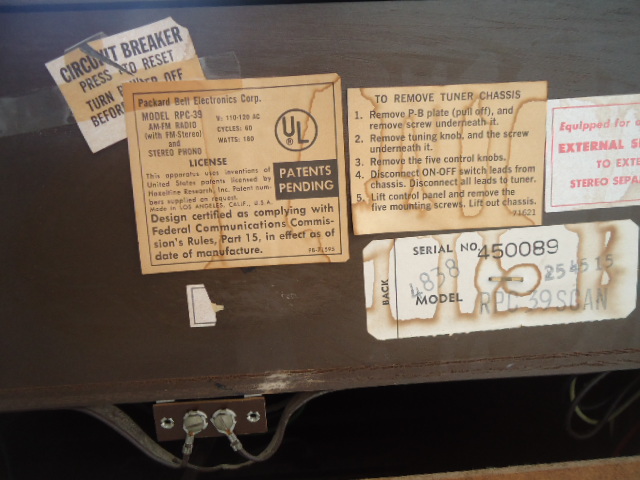

model & serial no.#
Speaker input....

Bobby Basham here at Phonoland can help you find a suitable needle. Look at the cartridge under the end of the tone arm and report back with any identifying words or numbers you find.
The turntable is a Garrard AT5LM. Its "manual" was a paper sheet installed on the turntable. The only reference I've found is this picture: http://bit.ly/K8rmZJ

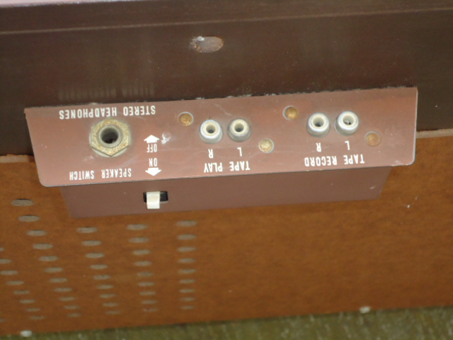

To play MP3s, just connect any player to the "Tape PLAY" jacks and select TAPE at the console.

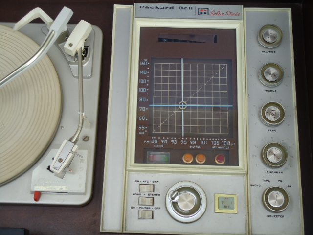

Before you can operate this stereo, however, you will have to hire a repairman to restore it. Its radio and amplifier section uses vacuum tubes at high voltages. The parts that drive these tubes deteriorate with age; if they fail, the entire stereo can be ruined.

To play MP3s, just connect any player to the "Tape IN" jacks and select TAPE at the console.

If you view the photos carefully, you'll see that the words "Solid State" on the radio clearly show.
That means, no tubes.
However, a service tech should still go over the unit to insure that the decades of neglect do not cause a future malfunction.

Incorrect. If you view the thread carefully, you'll see that I listed the tube types I found on the radio and pre-amp sections inside.
The "Solid State" label on the front panel merely advertises that the console contains solid state parts (on the amplifier, in this case) and doesn't guarantee that the console is all solid-state.
Consider it a 1966-era example of marketing speak. :wink:
