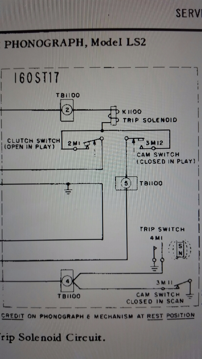

I will sum up: I have now to check the 36 Ohm and the 56k Ohm R in the Supply and i have to clean the switch 2M1 and 3M12. I am right?

In my humble opinion, of course it would be nice to check the resistor values, but if shorting the "W" ("2M-1" ?) contacts fires the detent coil, all you NEED do. is "clean" them as described above, and check the adjustment of them as per the Service Manual. The 3M-12 contacts are NOT in the detent circuit ( see the mech schematic), they are in the end of record, trip-off circuit. Ron Rich

Max I suggest checking those two resistors because pressing the trip relay and 2M1 contacts only checks the trip solenoid and wiring -it does not check the ability to readout and they often fail on all the older tormat models.
