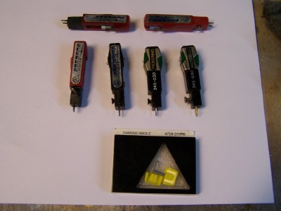

Here are the cartridges I used for the testing. The two 03D's seem to have the same output. I do have another 03D that is NOS but I doubt it has a higher volume output.
Both of the redheads I tried used older production needles, even though one set is a lighter blue. The new production ones have terrible output. You will also notice I added
a repro decal to the blackhead and as you can see it is much more shiney than the originals on the redheads.
After another listening this morning I do prefer the smoothness of the 03D cartridge as the blackhead seems to be just abit treble heavy...but the blackhead is a great cartridge.

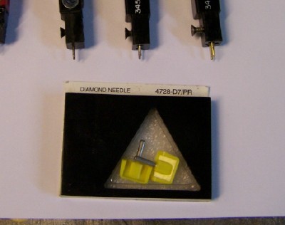

Rob: Are the yellow replacement needles in the photo the ones you use? I bought them many years ago.
Cartridges WEB.jpg (56.55 KiB) Viewed 1977 times
Re: Seeburg blackhead cartridge
by Rob-NYC » Sun Mar 24, 2013 11:36 am
juker wrote:Rob: Are the yellow replacement needles in the photo the ones you use? I bought them many years ago.
I don't know who/what made the copies I tried back in the 80's. After I got a "distributor account" with Pickering I was buying original yellow styli pairs for $9 and just got rid of the copy needles.
