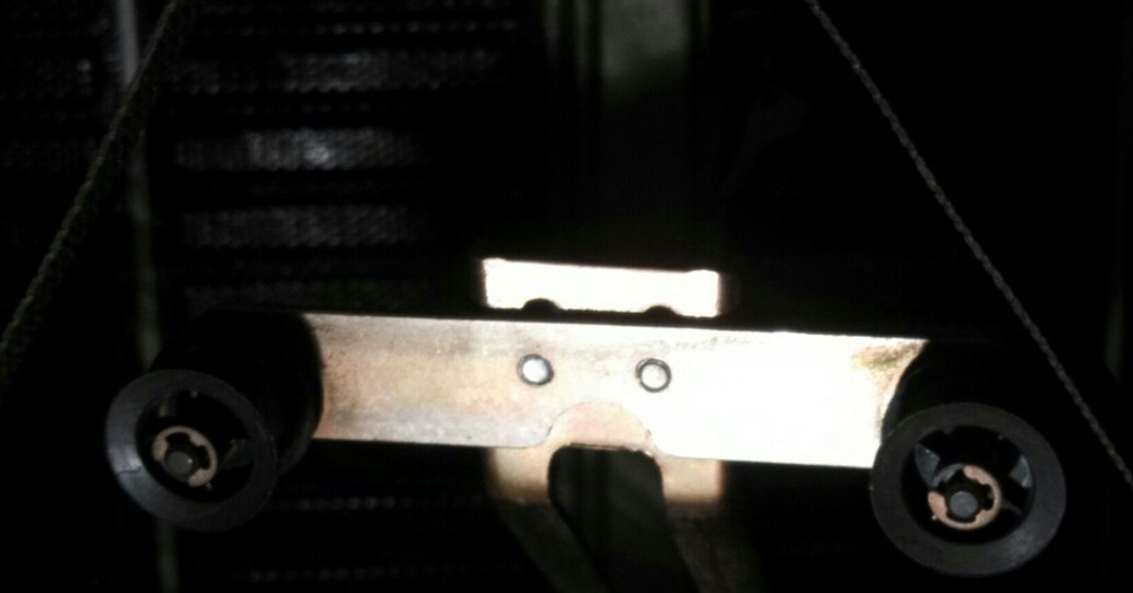

If I could figure out how to upload photos with all the restrictions, I'd show you where I am with the new belt. Either I'm not thinking of something or the company sent me the wrong size. It's well over the guide wheels at the top. I ordered the belt with an R-86 manual so I know they knew the model I needed.many ideas?

Hi Billie,
Sorry I can not see much from that picture.

by kw9598 » Tue May 13, 2014 3:31 am
I was just showing the 2-3" extra belt above the guide wheels in the record magazine.

Hi Billy,
The only thing I can see from your picture (I can't see the belt) is that there is plenty of adjustment to lift the Roller Bracket Assembly to take up the slack.
