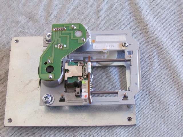

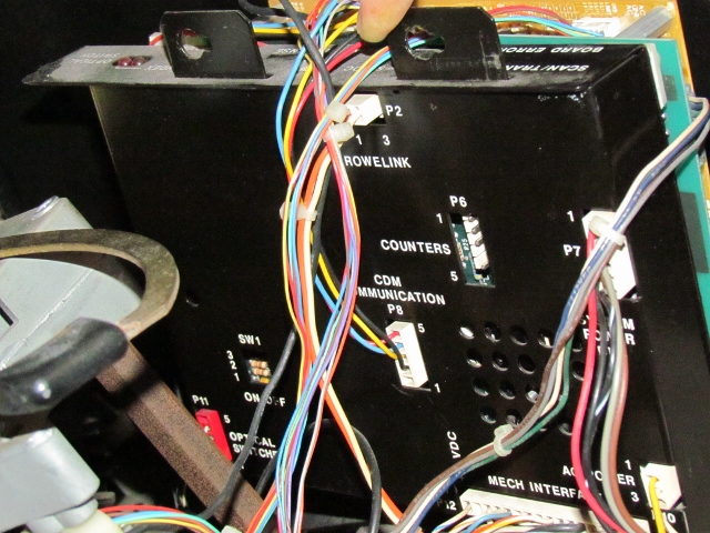

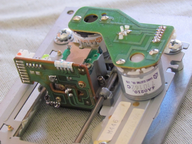

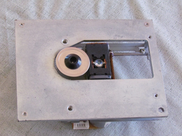

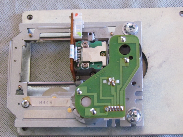

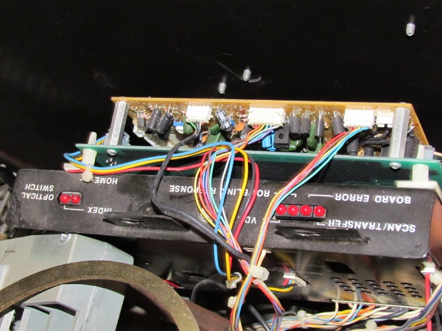

I made a mistake on the cd player is not a philips but it is a Sanyo?
I tried to find someone that can take a look of it to see if it is broken, but I didn't find nobody.
Thanks for all help that you can give me.
Max
max68
Posts: 8
Joined: Sat Feb 11, 2012 1:11 am
Re: Rowe CD100 Error 5-62
by max68 » Sat Feb 25, 2012 9:11 pm
These are the pictures of the Sanyo cd player and the Mec control.
I didn't find on internet this kind of cd player.
thanks
Max
