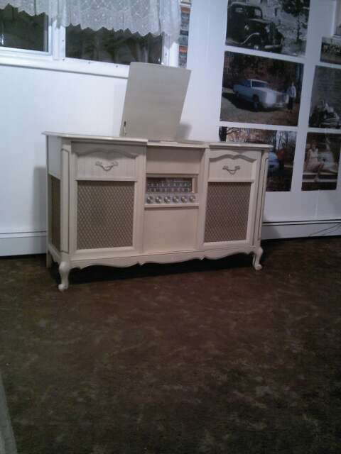

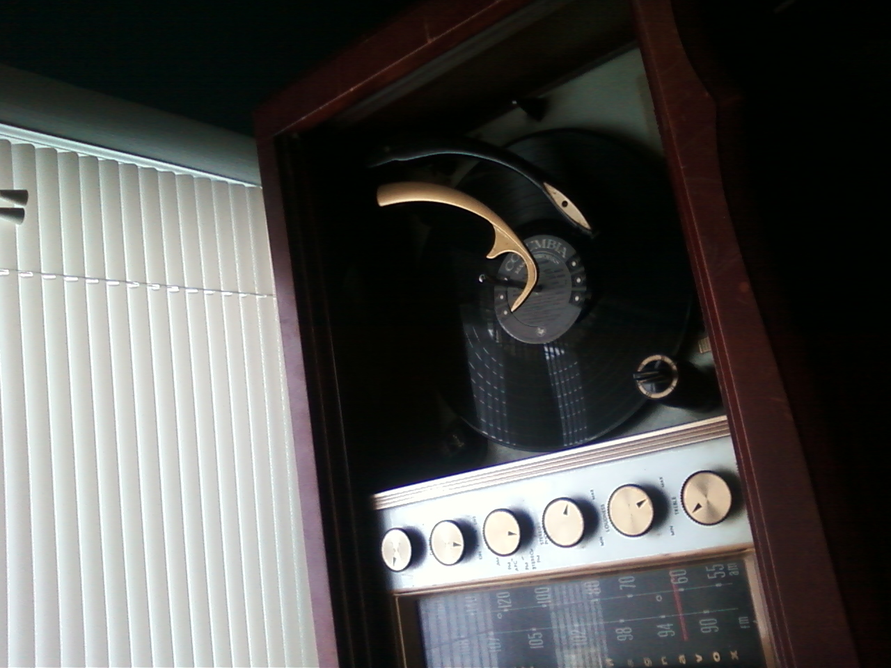

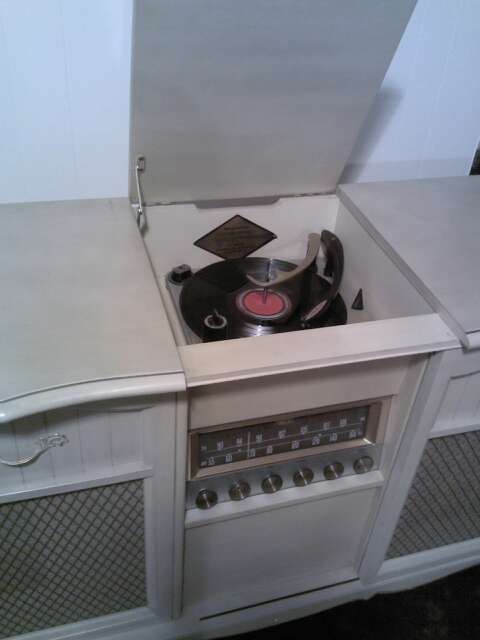

Once I got this gorgeous set in my house, I took a lot of pictures. What I want you all to see is pictures of my actually stereo. These arn't pictures I just copied and pasted from the internet. These are actually my pictures and I took them. As I said, I've waited for this set for a long time and I intend to enjoy it. I'm so proud of it that I just have to show it off!!
Clip of Magnavox Imperial Stereo while playing
Stereo Closed and with it's previous owner!
1960 Magnavox Imperial Stereo
Showing the Tuner and Record Player

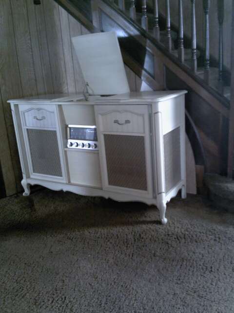

Re: Now Enjoying the Magnavox of my dreams
by MattTech » Tue Jun 25, 2013 4:08 am
71stereotheatre wrote:Well that's another great save! That is truly magnificent, the cabinet style and finish are superb! I have three French Provincial pieces, a 1966 Magnavox Beaumont, a 1970 40 watt console, and a 1971 armoire stereo theatre. I hope you can enjoy it as long as the original owners did!
The best thing would be to pull the plug, and have it immediately restored before anything cooks.
Once that happens, the cost of the restoration will skyrocket.
To quote someone recently on another site:
"I recently aquired a Magnavox Console, and everything was working fine - so fine that I thought I could (maybe) not replace the electrolytic caps.
Well I was wrong, and it took out the power transformer.
The tranny started to smoke and got really hot...."
by MattTech » Tue Jun 25, 2013 5:37 pm
In response to Michael's comments:
First, I am a professional electronics technician (see my bio) and have been servicing electronics for decades now.
The comment: "I have looked on the internet and know there are places that restore these units. Matt-Tech, maybe you should do a little research before leaving a comment like that"
That, made me laugh, because I'm advertized on several websites for vintage restorations. (including this one - do a search)
And I don't spout warnings jibberish over a keyboard just to see myself type.
I'm merely trying to educate the owners of vintage equipment as to the potential issues that arise, and save them money, and me the extra work of having to replace components that would normally not have to be replaced if warnings were heeded.
I also know for a fact that those Maggie consoles are prone to fried amplifiers, having serviced countless ones before.
They silently cook themselves to death, and are not fused, leading to massive destruction - the 50+ year old capacitors are long dried out and leaking from age.
Output tube grid voltages climb due to leaking coupling capacitors - the current draw on the power supply increases - a chain-reaction happens.
This cannot be seen nor heard by the normal person, until it's too late, and I don't care how cosmetically perfect the cabient is, or who owned it. - age STILL takes it's toll.
I don't care if it was sitting in the climate-controlled atmosphere of the White House Oval Room - it's still going to deteriorate!
My earlier mention of a Maggie console owner's post was to show how ignoring the inevitable cost that guy more money than he had to, and I've seen enough of cooked power/output transformers due to such ignorance.
Fact is, he knew the filter capacitors were a common (and mandatory) "replacement" thing, yet suffered the consequences afterwards.
Hey, it's "his" money, right?
Further, to assume I'm "jealous" is rediculous and inaccurate.
The comment "Quite frankly, Matt-Tech I think you are jealous that I have a "stereo" like this and you don't."
That also made me chuckle...
I happen to own a custom high-end RCA Victor console with top-of-the-line components that would blow away even critical listeners.
In today's dollars, this console would cost well over $5000 to manufacture.
Of course, it's been fully restored by me, to insure reliability for decades to come.
I also have a component system that would blow away any console made.
But I'm not bragging, just stating facts here.
As far as "throwing in the towel" I'm not one to give up on things - and I've had several tough restorations at the shop to deal with - and the customers have always been pleased.
I've restored Imperials, AND Concert Grands (the "top" line console) and know what I'm talking about.
I even own a Master Magnavox Service Manual that covers just about all models made - so I have the proper schematics to work with.
But insist as you will that you know more than me, because fools are a-plenty.
Finish I want my "Imperial" to be
Rose Baas Magnavox.jpg (6.88 KiB) Viewed 3677 times

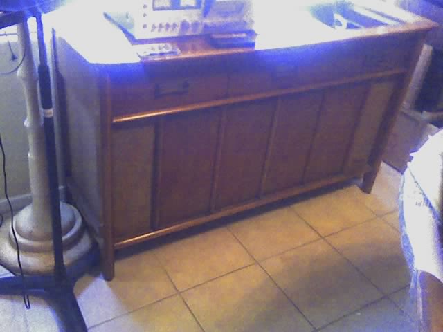

my old magnavox
Dot and Earl Mock Stereo.jpg (9.16 KiB) Viewed 3677 times

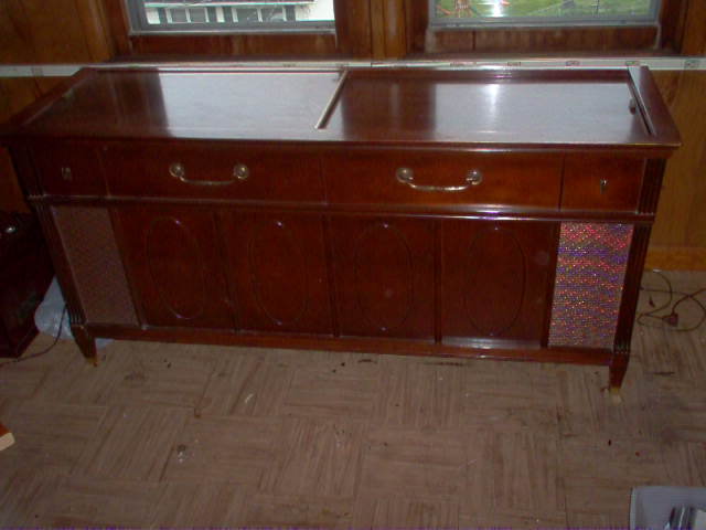

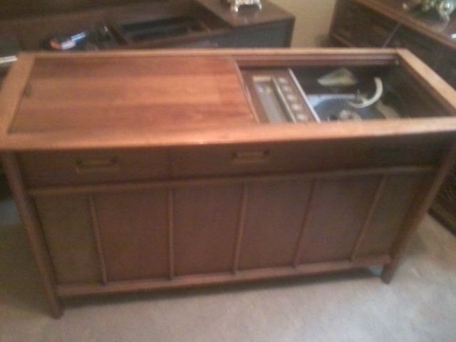

1961 Tube Magnavox given to me as a High School graduation present from my "Great Auntie Jean"
Dot and Earl Magnavox(Aunt Jean).jpg (7.21 KiB) Viewed 3196 times
1960 Magnavox "Imperial" that I got off of my neighbor Rose
1962 Tube Magnavox I bought from Thrift Store
Real long "Astro Sonic"
