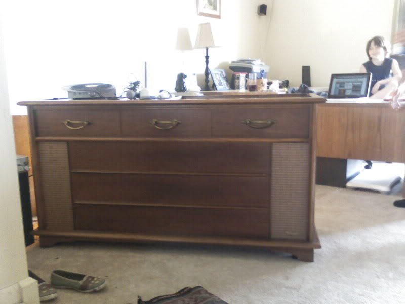

Hi!
Hope I'm posting this question in the right place. I have a Magnavox that I "inherited" when I bought my home. It seems to be in really good shape (in appearance). The problem is, there's no power. I've asked around and have been told it might be the fuse, or tube. It's says Magnavox Imperial Micromatic on the turntable, by the knobs it says Astro-Sonic. Model no. LS600, Serial No. 683433 (I found these on the actual turntable). On the back of the console: Model No. 1ST681A and serial 1985139. I hope some of this information is helpful! Thanks for any thoughts and suggestions!!!

Tried the on/off with the timbre know, but no luck. I'm really as huge a newbie as I could be with this, but it is such a beautiful stereo I would really love to get it going again. Image Any thoughts on how to find the year of this model? (Hope the image isn't too large, it's been a really long time since I've posted on any forums!)

by Bobby Basham » Mon Apr 06, 2009 6:26 pm
I have a unit the looks exactly like that one, with exception of the hinges and the base. Mine is on small legs. I opened it up a few years ago and found little stickers on the amp/receiver saying something like "9/65", so I'm assuming at least the amp was assembled in 1965. It also has a 600 series turntable with the black tonearm and a tall post with a 9 1/2" turntable.
In my unit, the on/off switch is on the Treble and there is no Timbre. Some models have the on/off switch on the Bass. Turn on that switch and make your selection for radio, etc. If in phono mode, there will be no power until you turn on the turntable.
If you get a chance to remove the back, look for little stickers pasted on the amp/receiver. That should give you a clue to the age.
Best of Luck,
BobbyB
