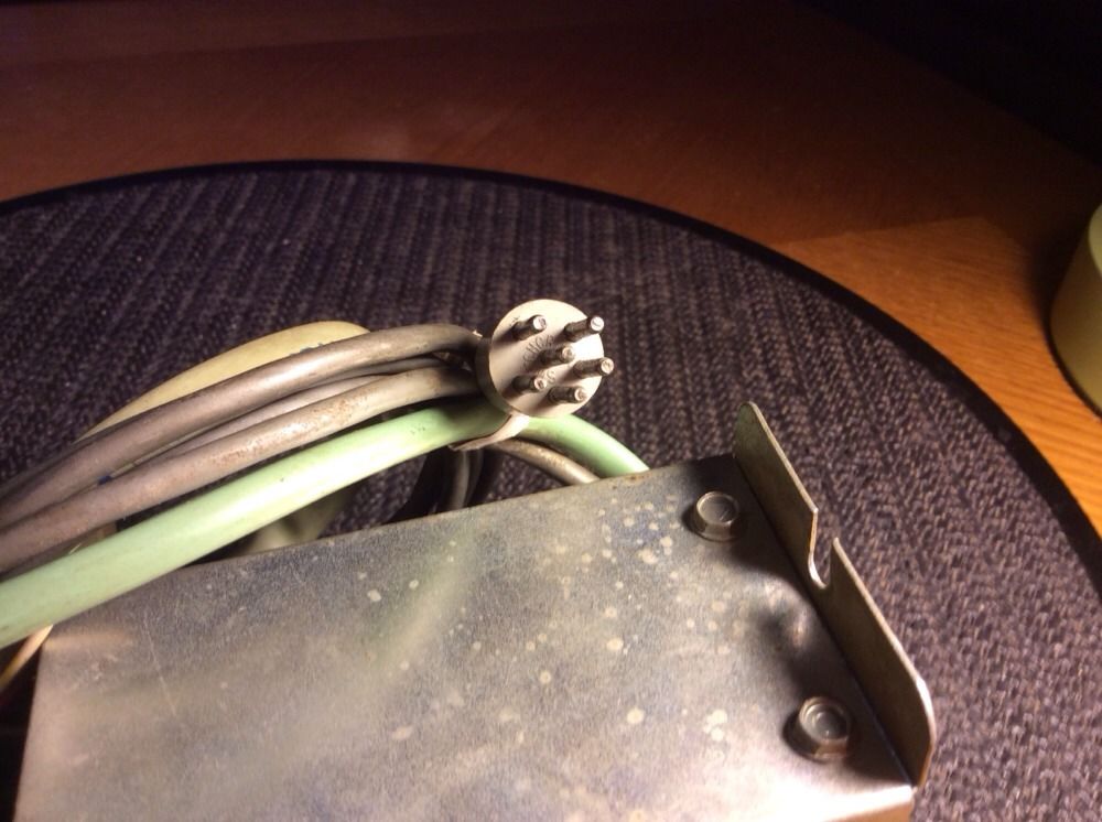

Recently picked up a Rockola 425. Did a full cleanup & lube and we are 99% of the way there. My lone remaining issue is with the volume input on the right side of the amp. #9 on the Amplifier Assembly photo in the manual, listed as a "6-Prong Miniature Socket"
It appears to have been tampered with, there are a few frayed wires and it is a loose connection overall. If I wiggle it around and hold it just right, the sound is perfect, but as soon as the basket starts up, there is just enough movement to jar it loose, causing a ton of distortion or killing the speakers altogether.
I'm wondering if there is a way to completely bypass the external volume knob with some homemade jumpers or something? I wont be able to get at the volume knob anyways as the jukebox will be back in a corner.

by Juke-rocks » Tue Oct 28, 2014 3:38 pm
Here's a photo of one of the molded the plugs, this one on a motorized volume control. When I take this photo into electronics stores I get blank stares. Seems like there ought to be a LOT of these somewhere. The remotes themselves are readily available on Ebay and the 5-conductor wire is standard.
Patrick

I've never even looked at, let alone touched that connection on my 425. The last photo in the thread looks almost like the wires were inserted in hollow pins and soldered at the tips. If it looks like solder at the tips, then maybe you could heat up a pin and pull a wire out, re-strip, and replace. If you can, than repeat for the rest (one at a time so you don't get cross wired). As I say. I am going only by what that photo looks like. You could even try unplugging it, spray some contact cleaner on the pins, and plug in and out a few times.
