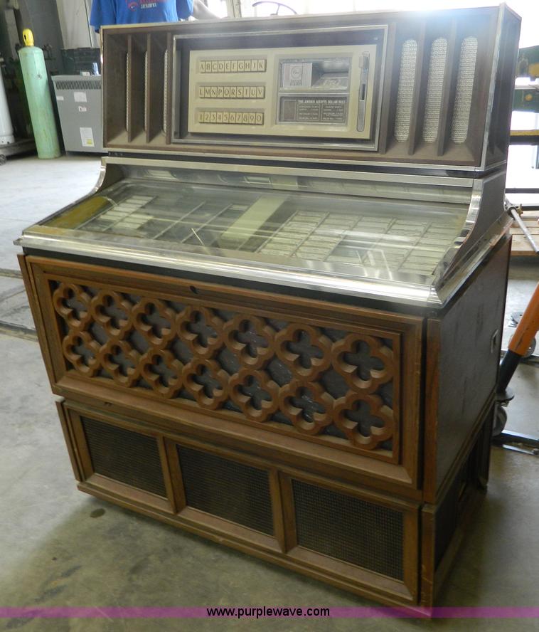

This is the exact model of the one I am behind. I really like that wood-metal combination, it is somehow sober among other jukeboxe's models and so the one to somehow fit the room where I want to put it!
As I would really like that the mechanism can be seen while playing, I thought about (I don't know if this will be reversible, if not I will not do it as I am very conscious about making changes on this kind of things) of removing the colored glass behind the woodwork in the front and placing instead a regular transparent glass maybe together with a blue coloured film that lets you see the mechanism through the woodwork with an uniform blue tone while inner lights are on. While not operating (inner lights off) the film will prevent the mechanism to be seen.

If the Rowe Ami MM-5 is as the picture posted then it is the Californian that was produced in 1971.
Best of luck with the purchase.

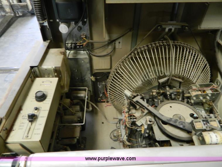

If you get the machine and the tonearm is anywhere but it's proper position -which here would be at-rest, DO NOT power it until you lift and reset the arm in it's proper position. Failure to do this can cause the tonearm cam to jam against the arm's cam followers and this can strip the fiber gear in the gripper motor.
The box on the left has the service switch, free play and record cancel buttons, the knob at the top is just for setting pricing.
Look at this pic (not mine) and it will be clear:
http://www.retroaudiolab.com/pictures/r ... talled.jpg

Hello Normende,
The combination on the B sides is B1, D2, F3, H4 etc.
John is correct re the service switch, reject and bonus/pricing switching.
If in doubt you can turn the transfer motor by hand using an allen key in the screw on the end of the transfer motor shaft. I tend to just operate it by turning the gears, this way you can inspect the fibre gear that often strips teeth (if this is the case you would need a replacement motor or a new gear, there is someone in the USA that has a service kit.
