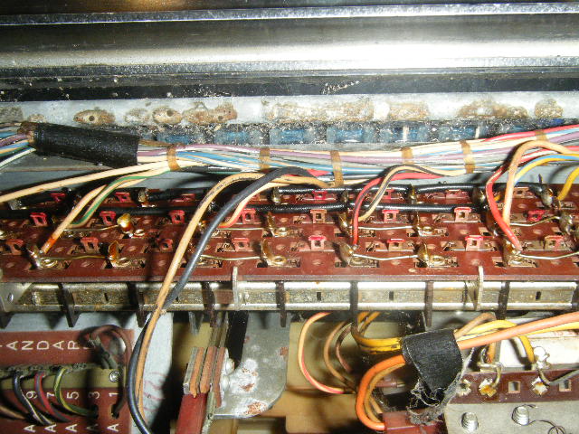

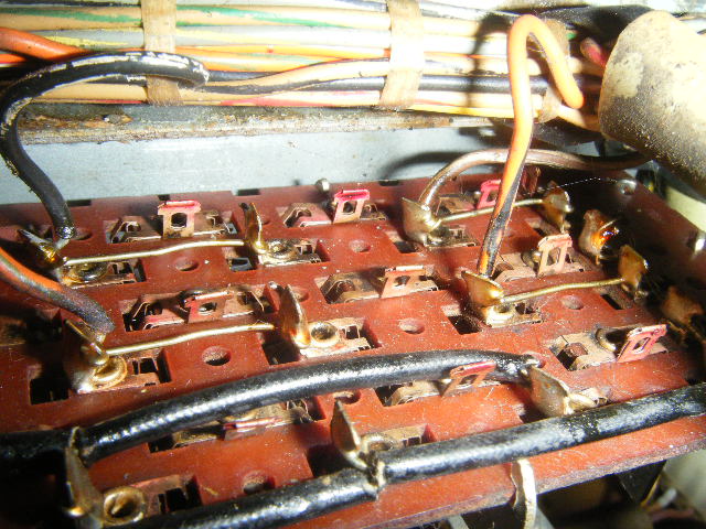

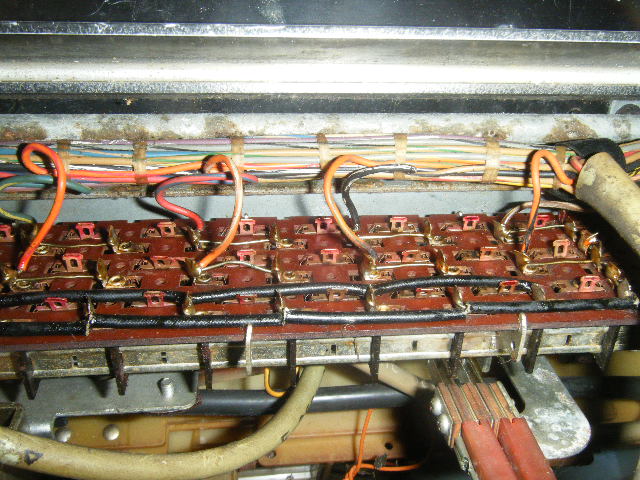

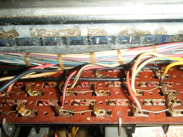

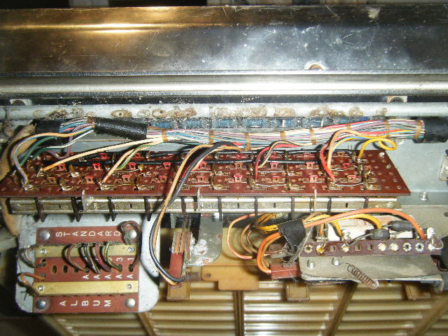

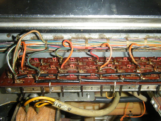

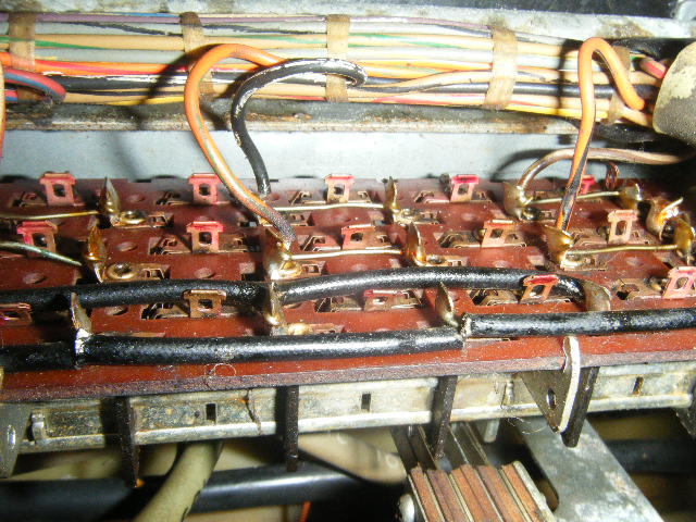

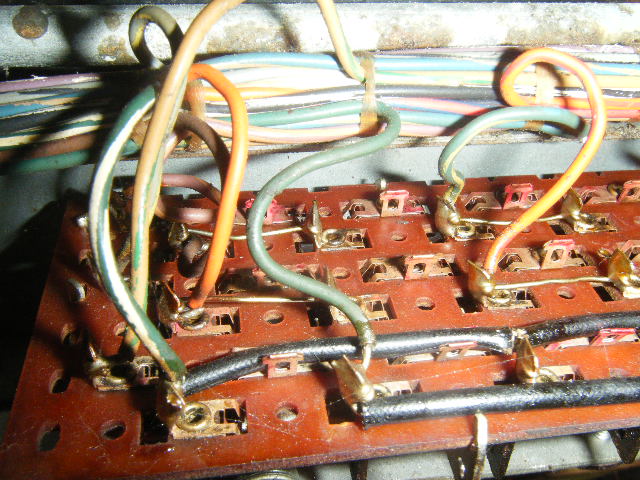

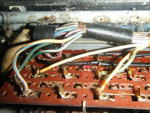

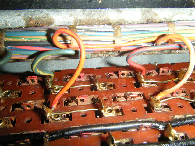

Attached are photos of the keyboard assembly, still can't get my head around the workings of a rockola keyboard
Clones
Picture 551.jpg (125.9 KiB) Viewed 453 times
Picture 550.jpg (124.22 KiB) Viewed 453 times
Picture 549.jpg (124.58 KiB) Viewed 453 times
Picture 548.jpg (126.36 KiB) Viewed 453 times
Picture 547.jpg (126.07 KiB) Viewed 453 times
Picture 546.jpg (127.03 KiB) Viewed 453 times
Picture 545.jpg (123.47 KiB) Viewed 453 times
