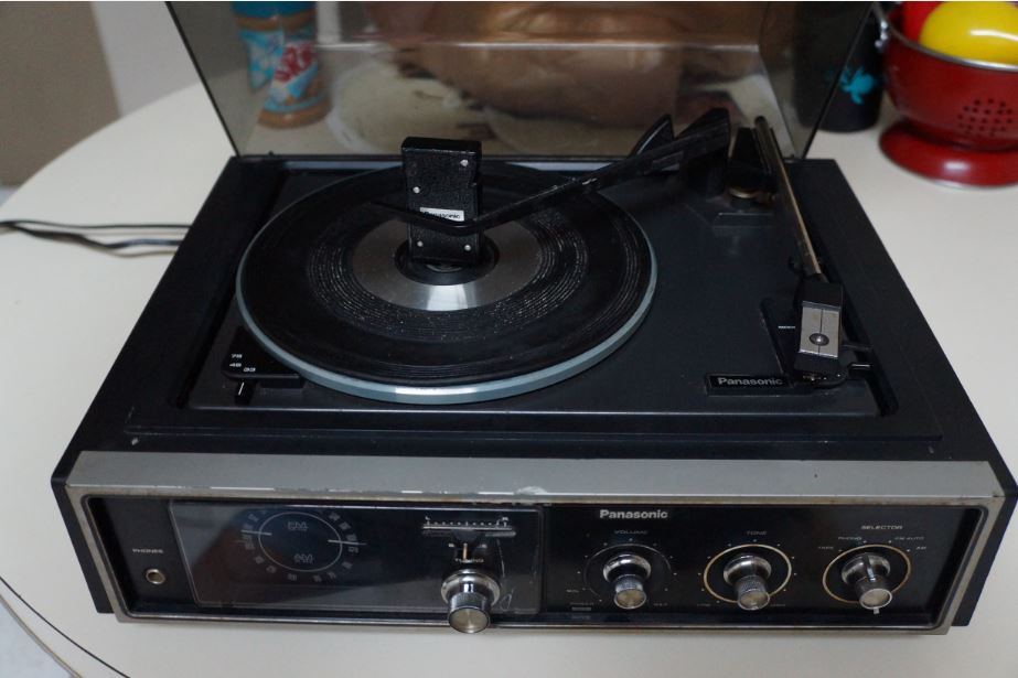

By great fortune, I stumbled across a Panasonic Model 30 (Center Unit Model: SD-201) turntable in the trash with a built in AM/FM receiver. I plugged it in to some speakers and the radio works wonderfully. The phonograph works as well, but I have to put the volume all the way up to hear the record very faintly. Could it be the amplifier or the needle? Please help. I really would love to get this beauty working. Let me know if any other specs would be useful. THANK YOU.

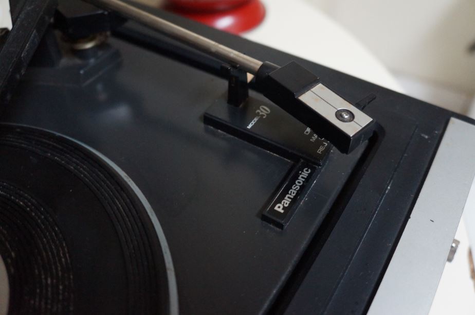

It will require a new cartridge, and since those old crystal cartridges are scarce now, a retrofit type of ceramic will have to be fitted.
Probably re-wiring, re-balancing and possibly input modifications usually are in the works.

I included some pictures just to make sure.

The spindle looks "twisted" because of the orientation of the 45RPM adapter.
If that's the case, the changer will require more work due to underneath issues now.
Nevertheless, it's got 40+ year old lubricants that need replacing, and possible rubber mounts dryrotting.
And those photos don't show me what cartridge was issued to that machine, they used several depending on the run.
Since it's not on my bench at the shop, I cannot comment further over the internet about issues I cannot see.
Best to locate a local servicer/restorer who can straighten out the unit successfully.
I can only advise on customer servicable things like needle changes, etc.

Lift the tonearm and take a shot of the ceramic cart. Then one of us can point you to a stylus.
Matt makes a point about the crooked 45 adapter. The spindle itself will have a lever that slants outward to hold, then drop the record. It should be diagonal opposite from the upper right side of the changer where the overarm pivots. Anything else could d be a problem although you can still manually play records.
