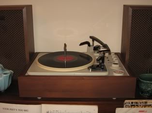

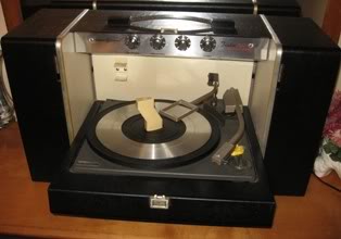

I just checked my two automatics I have out and running, and my GE Trimline 500 tracks at 5.5g, while my KLH Model Twenty tracks at 6.5g! I'm surprised; I thought the GE would track heavier... oh well... here's some pictures of 'em.
The GE
The Model Twenty with vintage Sony speakers
Eric Lee

Nice looking, just like mine.. I bet the wood speakers have deeper sound? At first I thought the slimline was thin, and maybe it is compared to a large system but I put the speakers on the floor on each side of it and sort of in a corner. It has reasonably sound that way.. At first I played it with the speakers attached, then I noticed a note on it that said to play it with them detached.. It does seem to make a difference?

The KLH sounds reasonable with the Sony speakers... I have it in my music room, mostly to play my 78's on. It has a mono / stereo switch, and a pretty responsive trebble knob. Makes my 78's sound warm and clean. The GE I have in my office, and I trust it to play my older 45's and LP's on. I try not to put anything near mint on it, because it does track heavy, but it plays my 50's 45rpm records very well! My grandmother bought the unit back in the early 60's, and... back then, it WAS slim! It's one of the last decent players GE made... that's just my opinion. I bought a mid 60's version, which oddly enough, was still a Trimline 500, but had some of the trappings of a Wildcat. (That nasty, cheap tonearm!) It was beat, and I salvaged the adaptor, then dumped the player. (Yes, it was that bad!) Overall, the system works well in a small space. I have had it for years, but have never separated the speakers! I think they tell you to separate them just so you'll get the full stereo effect. Have you bought a new stylus for it yet? They are on eBay; I have bought one, and it works perfectly! Oh, and did you ever fix your adaptor problem?
