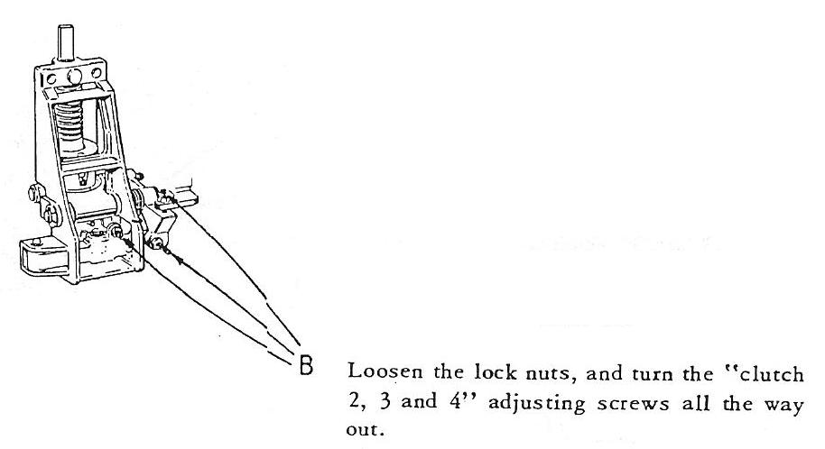

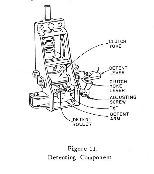

I'd like a clarification on the detent adjustments. As per the copies from the manual, I want to know which adjustment is #2, #3 & #4.
One is on the detent arm, one is on the clutch yoke lever and the other is on the detent lever. Which is 2, 3 & 4. I haven't found this clarification anywhere in the manual.

by Ron Rich » Sat Mar 28, 2015 9:38 pm
Hi Jack,
As per your drawing--the top one is 3, center is 2, and one on the left is 4--same as a jukebox--
My advise to you and all is: Do not re-adjust them-if working, no adjustment is needed, unless ( and usually not, even then), a part is changed !

Thanks Ron! After analyzing the next few pages of the manual I realized they were referring to the adjustments listed as clutch 2, 3 & 4. :oops:
