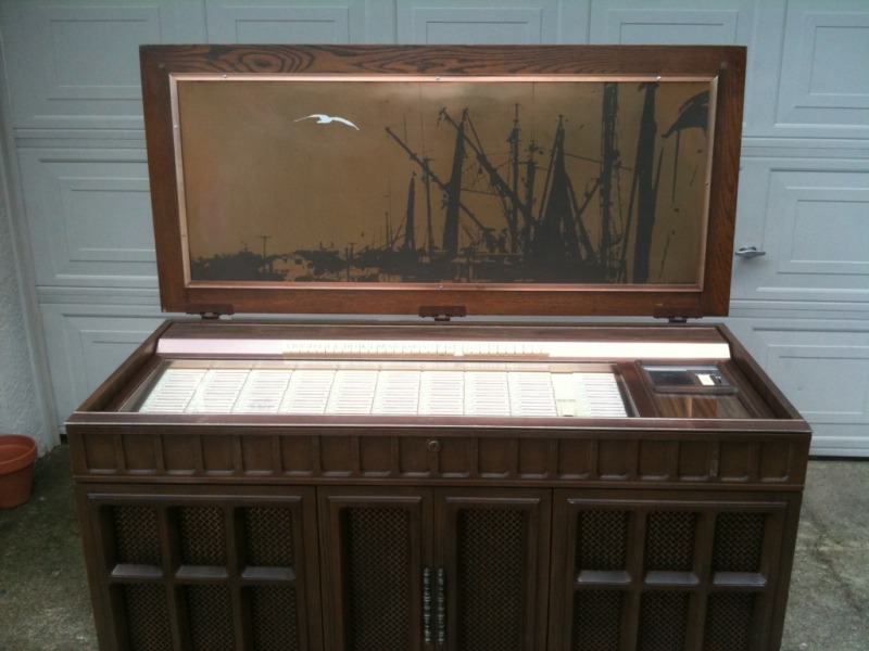

I think it is the Woodbridge. Here is a picture. If I'm wrong please tell me what it actually is. There is not much information on this model. Thanks!

by ami-man » Wed Nov 21, 2012 1:24 pm
Hello Kurt,
The jukebox you have shown in your picture is the 1974 Rowe Ami CTI-1 Crestwood.
It was the first of a series of Chest style jukeboxes tha Rowe Ami produced, this was the 1100 mechanism version (it used the same parts as the TI-2, R-74).
The next version was the 1978 CTI-1SC Camelot that used the 1200 mechanism/R-82 technology.
The last version was the R-84 version technology 1979 CTI-2 Kentwood, There may have been a R-89 based version however I have seen one of these.
