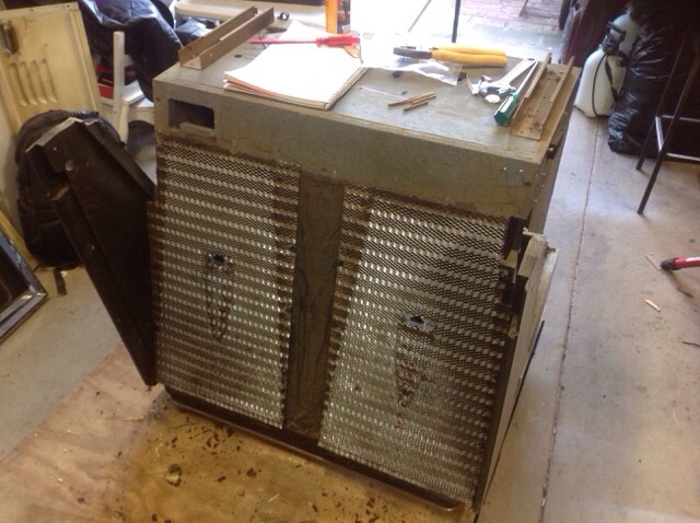

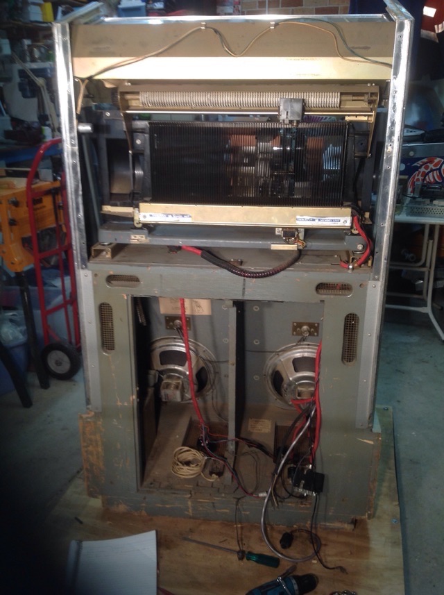

Quick update jukebox is now completely stripped a million photos taken to reassemble.
Time to assess what repairs and parts are required.
Both amp and selector require rebuilding looks like someone has had a go at repairing the selector reciever as there is a note inside saying that the power transformer is defective?
Also the unit arrived with no stylus/ needle any recommendations on a replacement?
