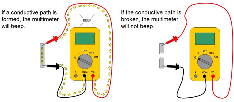

TESTING MICROSWITCHES
Multimeter in continuity setting. (BEEPES when there is continuity, doesn't when there's not)
Re: Rowe R74 Jukebox Rebuild
by Ron Rich » Thu Aug 21, 2014 6:41 pm
IMHO, That's NOT a valid test for switches !! Ron Rich
