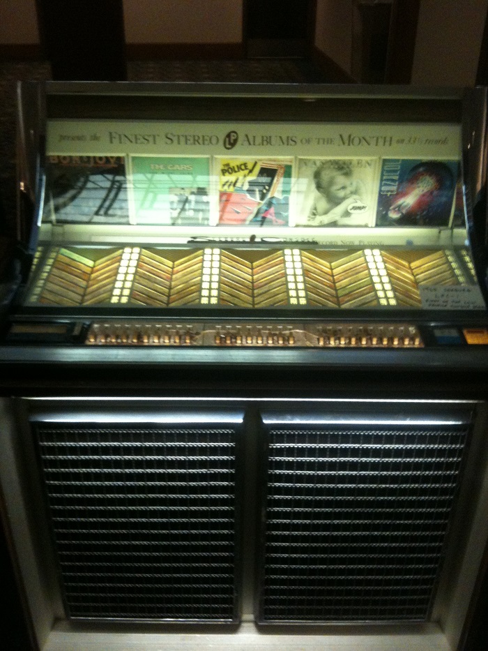

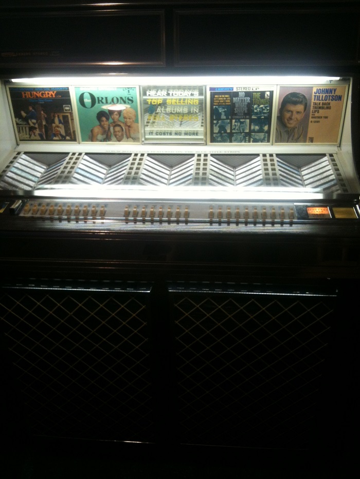

I was at a record show today where several jukeboxes, including a Seeburg LPC-1 were on display. I own an LPC-480 and I was struck by a difference in the two machines, and I'm wondering if my LPC-480 is missing something that should be a part of it.

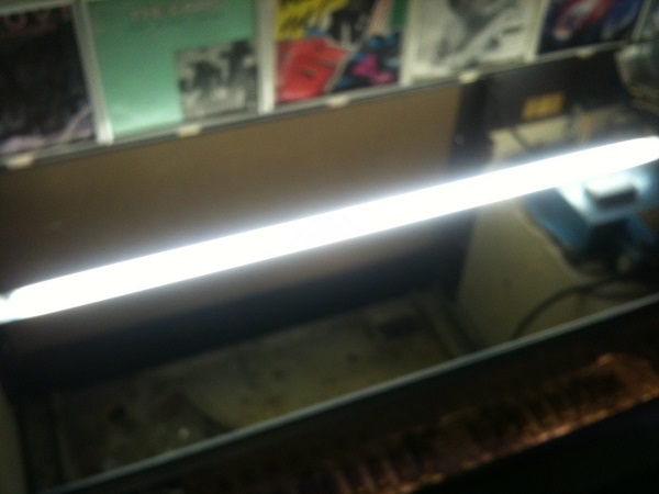

Pictured below are the LPC-1 from the show and my LPC-480. It was immediately evident to me that the selection labels (next to each title strip) are brightly illuminated on the LPC-1; not so on my LPC-480. When the owner lifted the lid on the LPC-1, there was a fluorescent bulb in place above where the mech would be.

LPC-1
MY LPC-480
FLUORESCENT LIGHT IN LPC-1

Not quite sure what you mean by "selection indicators" ? If you are speaking of "title strips, the 480's were designed to be "top lit", while the LPC-1 was "bottom lit", if I recall correctly.

But I think you've answered my question. The bottom-lit LPC-1 does a better job of illuminating those selection squares and even the title strips are somewhat illuminated. The amount of light provided by the top-lit LPC-480 doesn't really light up either the title strips or those little squares with the alphanumeric indicators on them. In dim light it can be hard to read those indicators in order to know what selection keys to press.

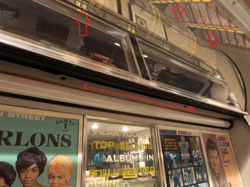

I think it may still be on there. Is that it, noted by the red X?
I also noticed something else when I was editing the photo prior to uploading it here. Notice how nicely those selection squares are illuminated from the overhead lighting in my family room! The jukebox is off, but with the lid raised, those squares light up the way I want them to. That proves something -- I guess it means the title strip holder is not too yellowed with age to allow light to pass through.

Ron is correct re his discription of a diffuser, it does spread out the light but the main thing is that you do not see the outline of the tube.
If the diffuser is indeed missing then you may be able to get one from the usual suppliers, in the case of a diffuser fitted into two slots you can make one by using theatrical gel (the plain obscured version is called frost) but there are about 300 plus tints available.

Yep--that thar iz it--can't tell from photo how much of it is left, or how it has been "stuffed" in there, as it should be covering the lamp--It should "hook" on the three holes--don't re-call if they go on top , or bottom, so look for the pegs that fit-em--(can see that the center hole on it, is "broken"--)
It also appears that you my have the wrong "frames" ( for album covers) installed--all should be white, except the center one with the "ad" in it.

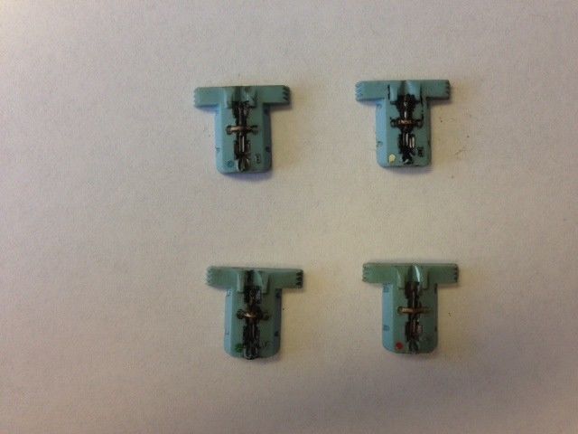

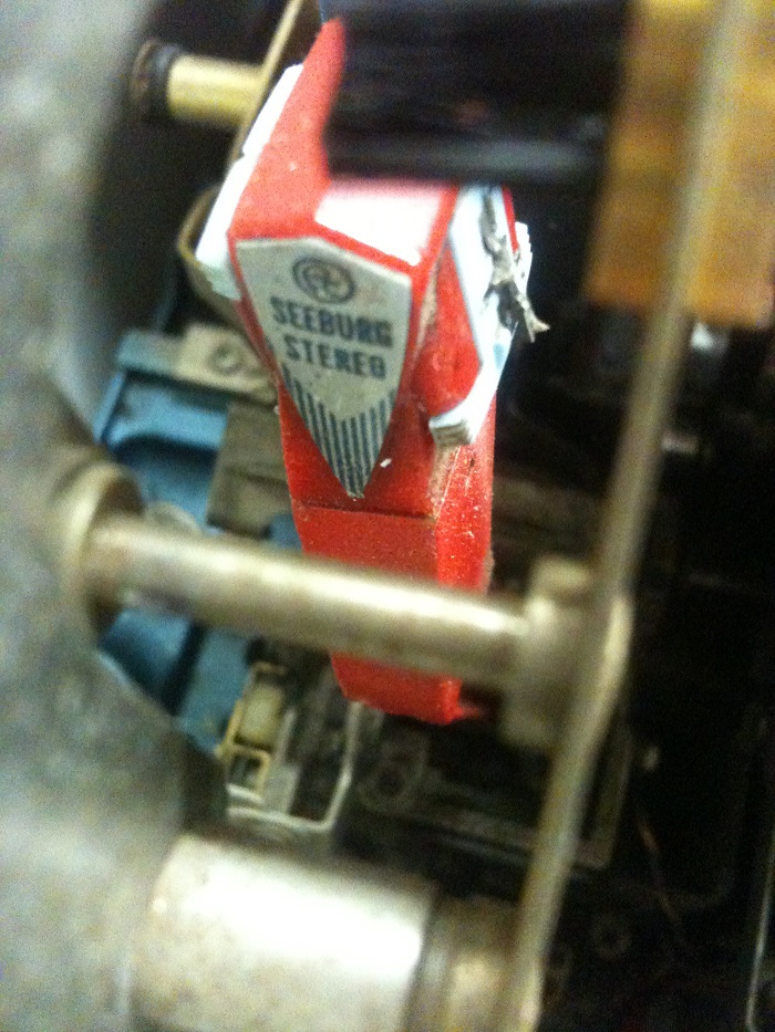

Oh yes, I've checked them all. There's a well known place in Hagerstown, MD not too far from me -- that is a good source for coin op parts. I'm sure it will turn up somewhere. I just bought 4 used needles from them to have on hand ... as backups, just in case. I do have the original factory cartridge still on there. From reading other threads here, I've learned that these needles are no longer being produced by anyone? Hoping I bought the right ones. Paid $33 for the 4 of them, but of course there's no guarantee on their condition, so I was taking a bit of a gamble. They should arrive within the next couple of days.
(Part # 249731)
Seeburg cartridge on my LPC-480
