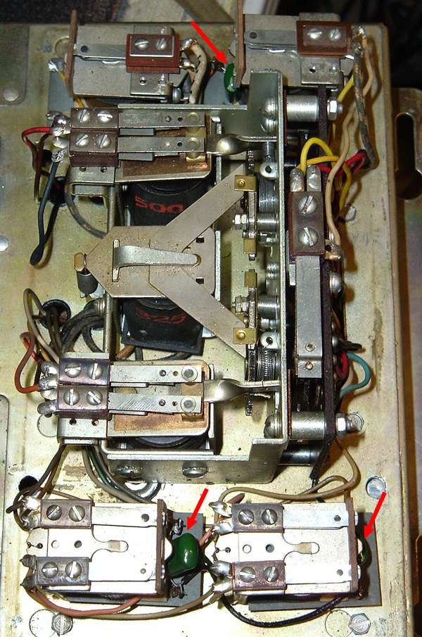

Ron Rich wrote:No--it's the RELAY, in the WSR-- Ron Rich

Ron Rich wrote:Junkman,
Iffin you have a cap tester--itz EZ-- Red "dot" is the common--one side should be about 1 mfd, other side should be 1.45 mfd
DISCHARGE it prior to testing--!!!Which brand motor is installed in that phono ?

Rob-NYC wrote:Depending on the way the meter measures it may be necessary to disconnect the cap under test especially given that motor is a coil which can easily affect the result.
If you can identify the two sections i suggest jumping them together (be careful here) and placing the mech in play which uses only one section of the cap. It is not an accurate sub, but assuming one good section the machine should run in play mode.

Ron Rich wrote:Hi Junkman,
If you can not read one section--it's bad--
Easier way to "jump" sections is use an alligator clip to temporarily close the "O" contacts-- WITH the power OFF !!
However, depending on the mechanism's "condition" (proper lubrication), the motor may, or may not run with just one section of the cap ?
