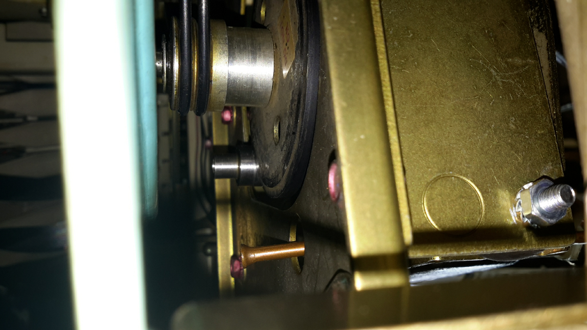

by hdt22 » Sat Aug 27, 2016 10:43 am
Hey Guys,
Another update, the dinking tool worked perfectly. Have approximately 30 records far with no breakages. Fingers crossed it stays that way. I
have also made the new drive spool for the turntable motor, i now have it running at 45.4rpm. The juke is functioning fine so far, i have it accepting coins, selecting pins, and playing.
The amp is functioning fine but seems a little fluttery at times. It's there a cap kit can be put through this amp?
Cheers
Corey
