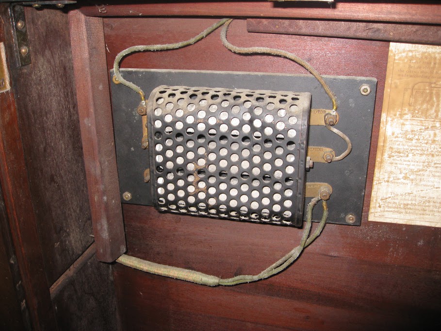

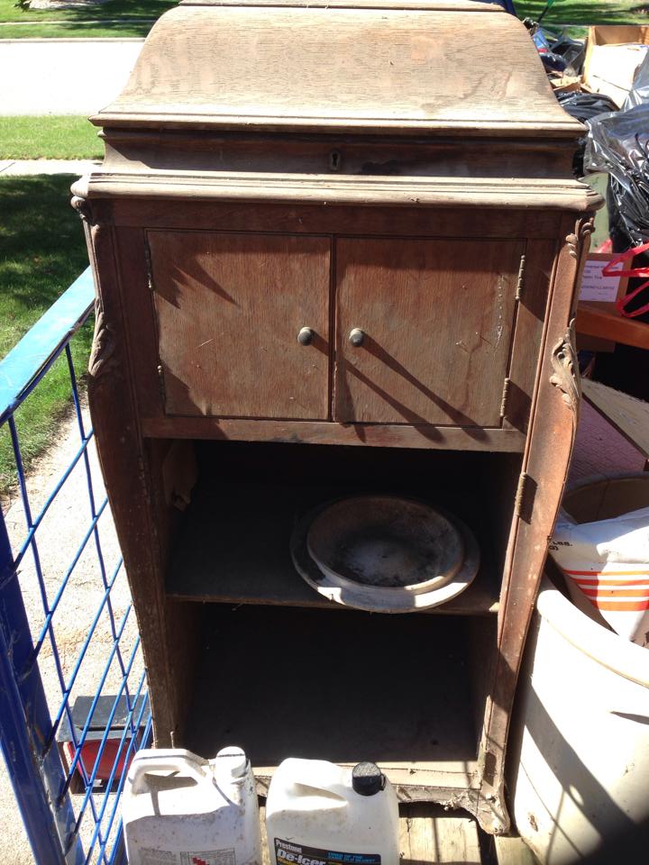

Looking for advice on if I'm biting off more than I can chew. I rescued this Victrola VE-XVI (1913-14 range) for $20.

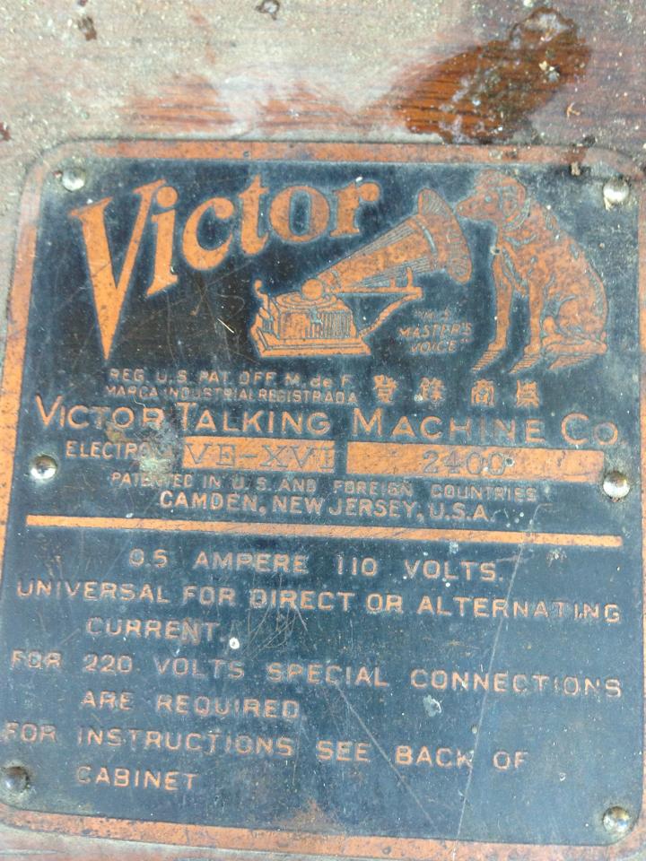

serial plate
Most but not all of the internals are there. I'm finding very little on this specific model since it was so early of a an electric motor. I know I'm missing these (don't know what they are called)
missing this stuff
If I understand correctly, this was used to convert power between 110/220 depending on the power grid back then. Can this be re-wired using modern components?
This is my first 78 phonograph. Not afraid to get dirty and don't have much invested yet. Willing to put $200-300 in the internals. Cabinet restoration isn't a concern. Missing both front lower doors and both back panel covers. I can take some better shots of the internals tonight if it would help.

It would be my guess, that you have a photo of some resistors there--
Most likely it can be updated using newer components--but one would need to have either knowledge of what was required, or a schematic to figure it out. Ron Rich
