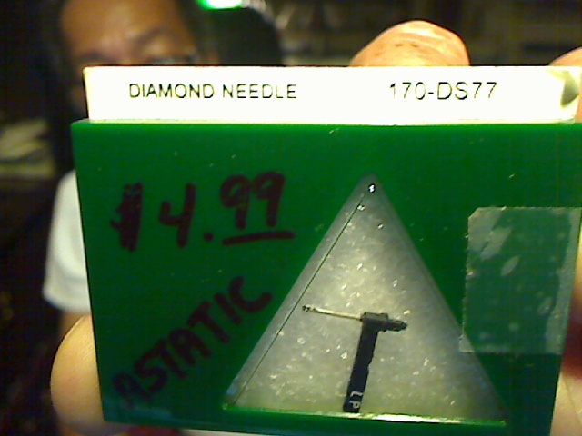

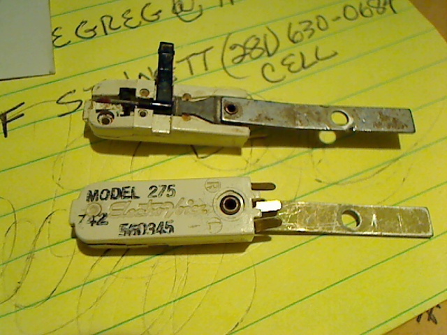

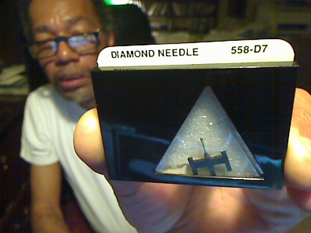

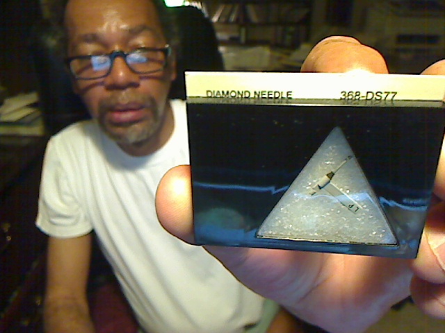

Thanks, Ron, for beating me to that reply. Some folks are visually stimulated but can't comprehend the printed word. I hate to post a gazillion pics again, but folks who join a room should read the old posts before posting a question that has been answered many times.
TEETARA, take a look-see at what you actually have. Get the number(s) off the cartridge. An Electro-Voice EV275 or an Astatic 165D should cross to a Magnavos 560345 or something similar. Cabinet models and serial numbers have nothing to do with the guts inside your cabinet. You will find several needles that will fit.
Picture 55.jpg (110.4 KiB) Viewed 4274 times
Picture 8.jpg (95.99 KiB) Viewed 4274 times
Picture 11.jpg (91.76 KiB) Viewed 4274 times
Picture 10.jpg (83.67 KiB) Viewed 4274 times
Picture 9.jpg (89.27 KiB) Viewed 4274 times
