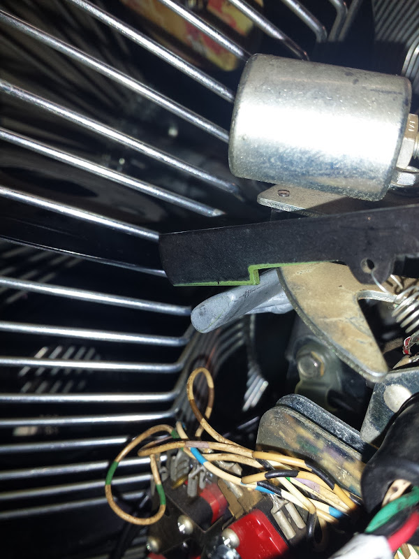

I do need help with one adjustment in my mech. Not sure which gear or cam is out of whack.
Note the image:
This is a shot of the end of the tone-arm cam, with the black spring-held lifter resting on top, like it should.
The problem is this - when the transfer arm is down, the tone-arm cam is not rotating enough, so that the black lift-arm isn't being lifted enough. What happens is that on thicker (the more brittle) records, this is no problem. But on thinner newer records, by the time the tone-arm gets to the inner grooves, it starts to float over the record - not enough weight to keep it in the grooves.
Now, if I adjust the tone-arm cam counter-clockwise, even a smidge, the tone-arm then moves over the record TOO SOON, and ends up catching the transfer arm ON it. (This, of course, is VERY problematic..!)
So seeing as how I cannot adjust the tone-arm cam any more, what else should I be looking at? As per the manual, all adjustments in the manual (as far as ones relating to tone arm and transfer motor/arm/cam) are in line.
-Mike

Mike, this is one of those 'tricky-finesse-y" adjustments.
You only need the slightest clearance between stylus and gripper bow:
http://s1192.photobucket.com/user/Rob-N ... rt=2&o=109
http://s1192.photobucket.com/user/Rob-N ... rt=2&o=108
Check to see if some Gepetto has bent the crescent-shaped flange that lifts the arm at an angle. That is usually what causes this problem. You may have to bend it again slightly to establish a compromise position. There are several somewhat crude fine touches necessary on these mechs. Another is to boot the cam with pvc tubing to make it lift the lever higher. This is usually done when the lift lever has worn a notch in the cam profile. I don't see that in you pic so it should be a matter of fine adjustments and slight bending.
I always took the mech through it's paces manually (no power) so as to avoid and strains and jams. from my, or other's wrong settings.
The good news is that once done you won't have to revisit these adjustments unless you replace the cart.

  1. This is a new issue - I believe(*) - since rebuilding the mech and aligning everything per the manual. (* - I'm not 100% sure, since before this period, I had only one or two records in the mech to test on. Now there's more records with different thicknesses.)
  2. Also, it seems to vary - on the same record, sometimes the needle will grip - not float - all the way to the end. If I were to guess, the transfer motor is moving (spin-down?) slightly more at times when cutting off, and when it does, it's giving enough lift to the arm that the needle's not having any issues.
  3. The needle in there is brand new, used for only a few records now. (I had a new one, and replaced the old one when I reassembled everything.) It's POSSIBLE that this needle is more 'compact' than the old one. (The old one was very, very old.. Had to be from the mid-80's, from the style of the plastic housing on it.)
  4. I don't think the needle is any culprit, however, as when this happens, the tone-arm is being held up enough to where it's not falling against the 'no-record' cancel plate. (Screw in the tonearm, without a record the tonearm drops too much and this screw rests on a metal plate, making electrical contact to cancel the record.)
  5. *I* adjusted the tone-arm lift rod (the item Rob-NYC mentions) to follow procedure on the needle clearing the transfer arm. (The exact adjustment in Rob-NYC's scan.) I am going to revisit this tonight, and verify that I didn't over-adjust it, lifting the tone-arm up too much. :mrgreen:
Thanks again guys. This has been fun. :)

Let me re-iterate -
WITH the cartridge AND needle that is in there now, I did the stylus-clearing-the-transfer arm adjustment. And it DID need adjustment, I bent the arm up ever so slightly. (Remember my cart was loose, I posted in my resto thread. Once I glued it back into it's .. er.. housing, it was a little low, and the needle was scraping the bow. My adjustment was perhaps.. 1/16th of an inch.)
I do not think that crescent is bent - however, I will have to check that tonight. I think Rob got close -
Rob-NYC wrote:The gripper motor is AC so it uses a rotor that has to snap back from engaging the gear and this must happen the instant power is cut to it. If these motors have been run for long periods without oil, or the wrong kind of oil, rotor retraction can become sluggish and cause coasting.
In my case, however, when the rotor releases QUICKLY (as Rob says it should) then the cam arm isn't raised enough, and the issue occurs. When the rotor 'hangs in there' a little longer, then the arm is raised enough where the problem does not present itself.
I did notice something last night, while looking at it, and this may be the cause. However, I'm not sure how to address it -
When the record is PLACED DOWN, the transfer motor stops as it should. (Rotor snapping out right away, or not.)
However, when the record is canceled, the transfer arm assembly (tone-arm cam, the gears and half-gear from the transfer motor) continue in the forward motion some, before reversing direction to raise the tone-arm and allow the arm to clamp on the record. (I will get a video of it tonight, in case my words aren't descriptive enough.)
It's as if the transfer cam is hitting the motor cutoff switch before the cycle is completely finished - and when the motor resumes, it's finishing the motion and then starting the pick-up motion. Exactly as if the transfer switch cam needs to be adjusted.

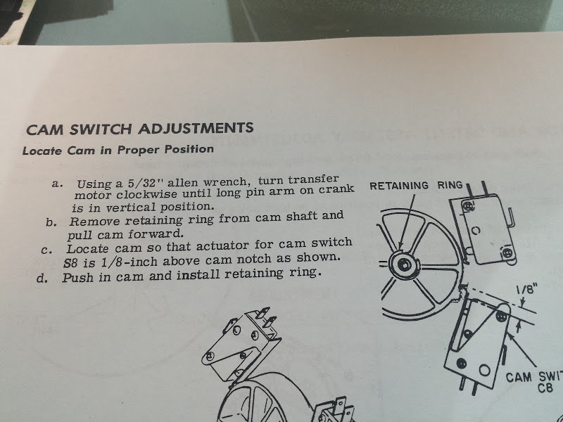

And funny enough, there's a page in my manual about adjusting the switch cam:
However, I CANNOT PERFORM THAT ADJUSTMENT. My switch cam has a notch in it, that mates up with a roll-pin that is through the drive-shaft that the cam mounts in - so I cannot rotate the cam to adjust it at all. (And, nevermind that it's calling cam switch 5 "8" - apparently this page was pulled from an earlier model and never updated. D'oh.)

Two thoughts come to mind here---
1. Check that cam switch,with an Analog meter, as shown in a post above--it may be having problems !
2. It should be adjustable as to where - when it triggers, by loosening the mounting screws and sliding it closer/further from the cam.
