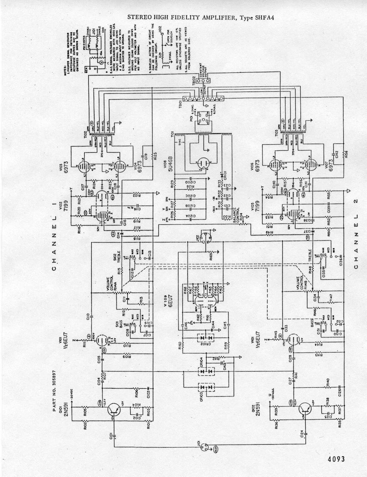

Here is a schematic for the amp that is -likely- in your machine:
http://www.verntisdale.com/schem/shfa4.jpg -BTW: Has it been rebuilt?

My amp is SHFA4 See the pic). I serviced it about a year ago... all new electrolytics and replaced all resistors which were found out of specs as well as power supply resistors. The amp itself sounds fantastic, however I believe the dynamic range and channel separation is very limited by the single pair of 12" red speaker cabinets.

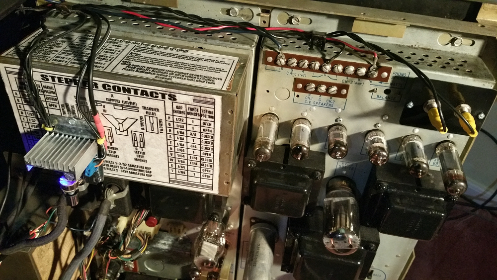

I finally had time to complete this extension speaker project.

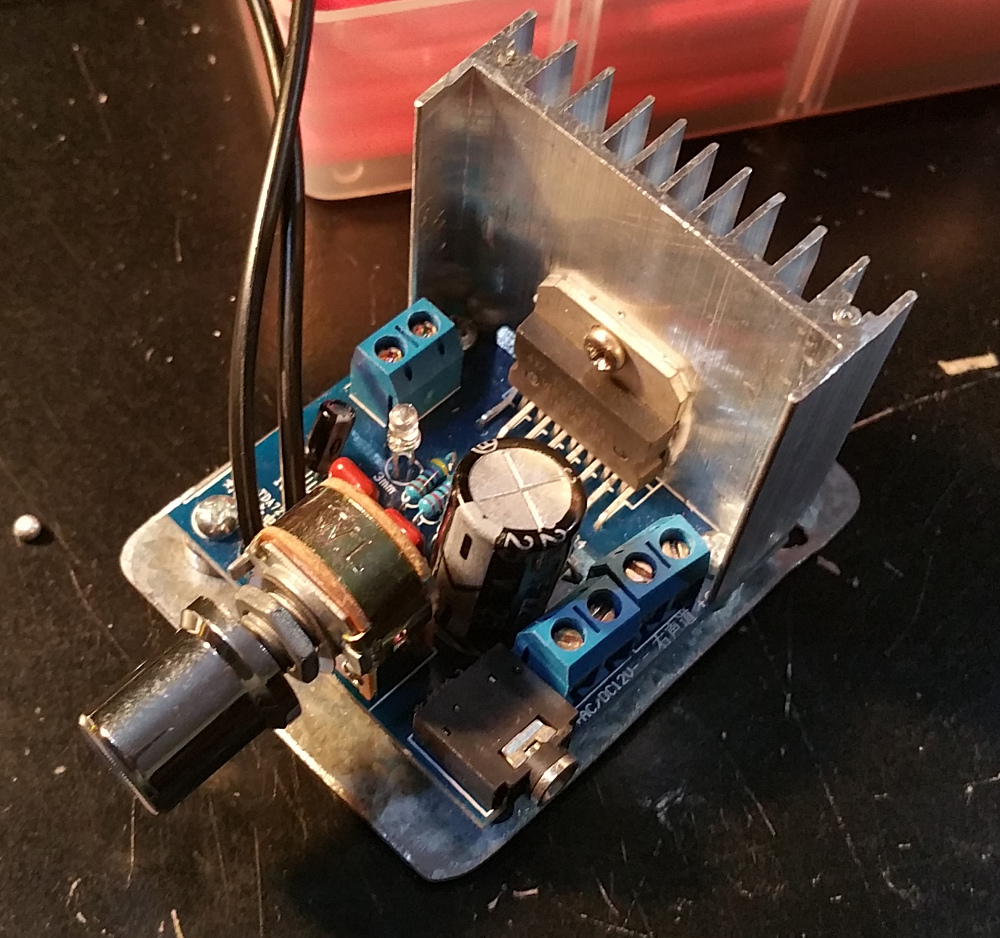

I bought a cheap ($4) Chinese 15wpc stereo amp from someone on eBay. It came complete except I soldered a pair of short coax to RCA jacks to it.
I made a plate for the AY-160 amp to fit over the volume control hole and put a couple panel mount RCA jacks. These panel mount jacks go through a .01uf cap onto the AY-160 volume control wipers.
I fabricated a mount for the cheap Chinese amp and attached it to the stepper receiver cover.
Power supply is a 19v 2a old laptop switching supply which is just laying on the bottom cabinet board next to the coin mech.
Works awesome, thanks again for all the tips here.
