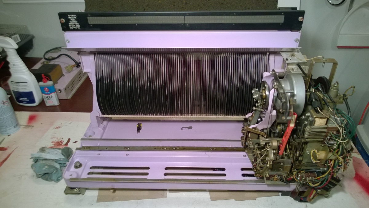

First time poster here. I'm jumping into the world of Jukeboxes. I purchased a Seeburg SS160. It's not working. It scans properly and pick the correct record but stops as soon as the needle hits the record. The plethora of information here seems to indicate either a gunked up clutch assembly or probably the large cap in the auto speed unit.
I'm in the process of cleaning the whole assembly right now and it doesn't seem too bad. I'll clean the contact points and lubricate all the moving parts and re-install and see what happens. I'm assuming I'll have to change the large cap (and maybe a few more) to rebuild the auto speed to correct this problem.

Attached are a few photos so everyone can see where I'm at. As you can see from one of the photos, I have the red arm. Maybe this is where my sound issue is. How difficult is the swap out to the blue\green arm if this is the cause of silence?

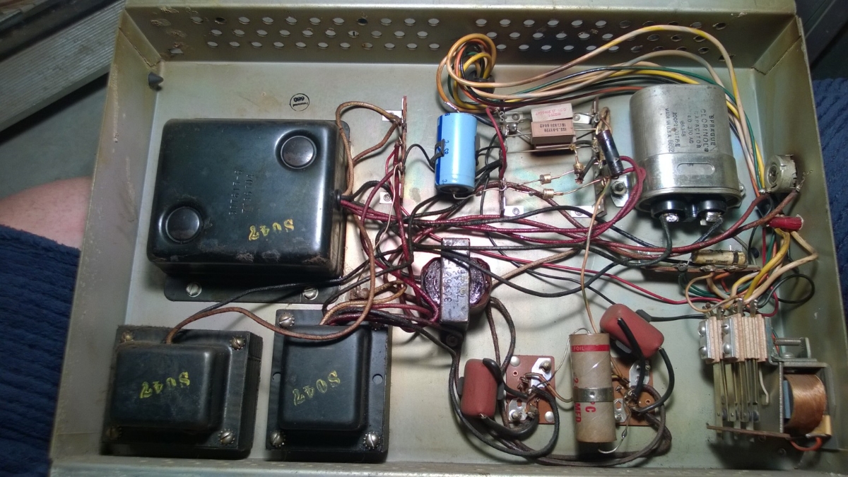

I'll be lubricating and hopefully re-installing the mechanism tonight. Due to the lack of old grease build up, I'm thinking I will need to replace the big cap in the auto-speed module. Any vendors here that can supply? I'd rather spend my money with people who have helped me out.

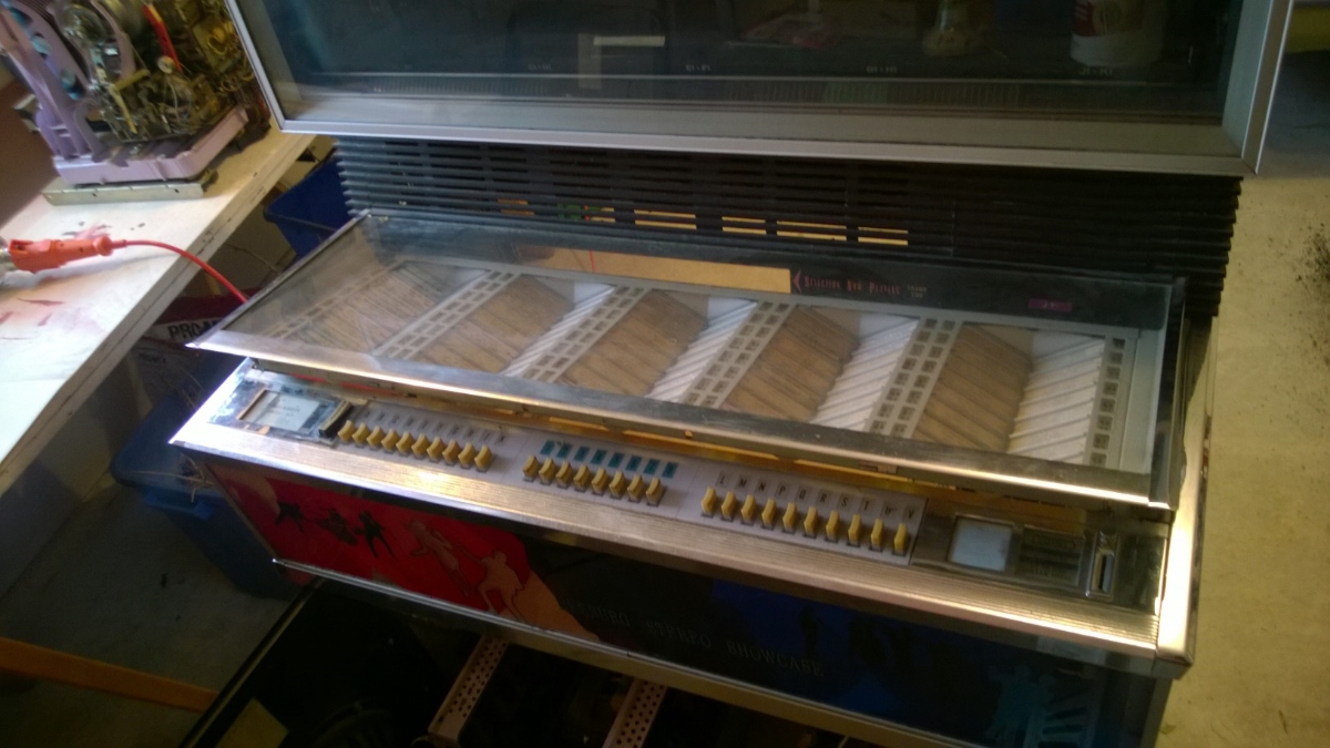

I have more issues like the two small lights for selection display are not working and the rotating display motor just hums loud (disconnected for now) . Nor does the top florescent light illuminate (I'm assuming the ballasts are to the lower left behind the power supply) but also tasks for later.

Jack, the speed unit has nothing to do with rejecting the record. if that fails all that will happen is the mech will stop dead when a 45 mounts.
The causes of rejecting are:
-Shorted trip switch on the tonearm assemble. these are delicate reed switches and they do (rarely) go bad.
-Shorted-jammed reject button on rear of machine.
-Old, gummy oil in clutch assembly. Here is a lube chart: http://s1192.photobucket.com/user/Rob-N ... ort=2&o=18
There are a set of contacts on the mach that open the trip relay after the the SCR conducts on play-trip, but these are unlikely to cause your problem.
On the lube chart at the front of the mech there is a "manual trip lever". It is just to the left and slightly lower then the vertical contact stack. When the machine trips at a selection that lever will swing up and it should then fall down in about one second. If it doesn't fall down try pressing it down. If it tries to pop up again the problem is electrical as in 1&2 above. If it let's you press it down and stays down the machine will play the record. In that case it is likely lubrication of the clutch assembly at fault. read the post on the "G" problem and Ron's suggestions there too.
As for having sound, this machine is now almost 49 years old. The amp -must- be rebuilt with new capacitors for reliable, safe operation (and decent sound).
These transistorized machines are the simplest and (IMO) easiest to service of any Seeburgs.

Jack, there is something weird going on here (not reassuring to read, I know). From your vid it appears that the pop meter is firing twice -does it? And I don't see the manual trip lever flipping back up as the mech rejects. Maybe it is just the angle, I'll D-L the vid and look more closely.
At this point and given the sound of the pop meter, I suspect a gummy clutch.

Ab-sol-lut-ly, without any doubt, it is a stuck clutch yoke PIN ! Nothing else will cause the "double click" on the pop meter !

You are confusing yourself--You have (at least) two different problems--
1. The Autospeed is not functioning-- this is shown in the first vid, where the mech just "hangs"--
2. When it rejects the record (second vid), prior to playing, it has a mechanical problem in the clutch yoke pin.
