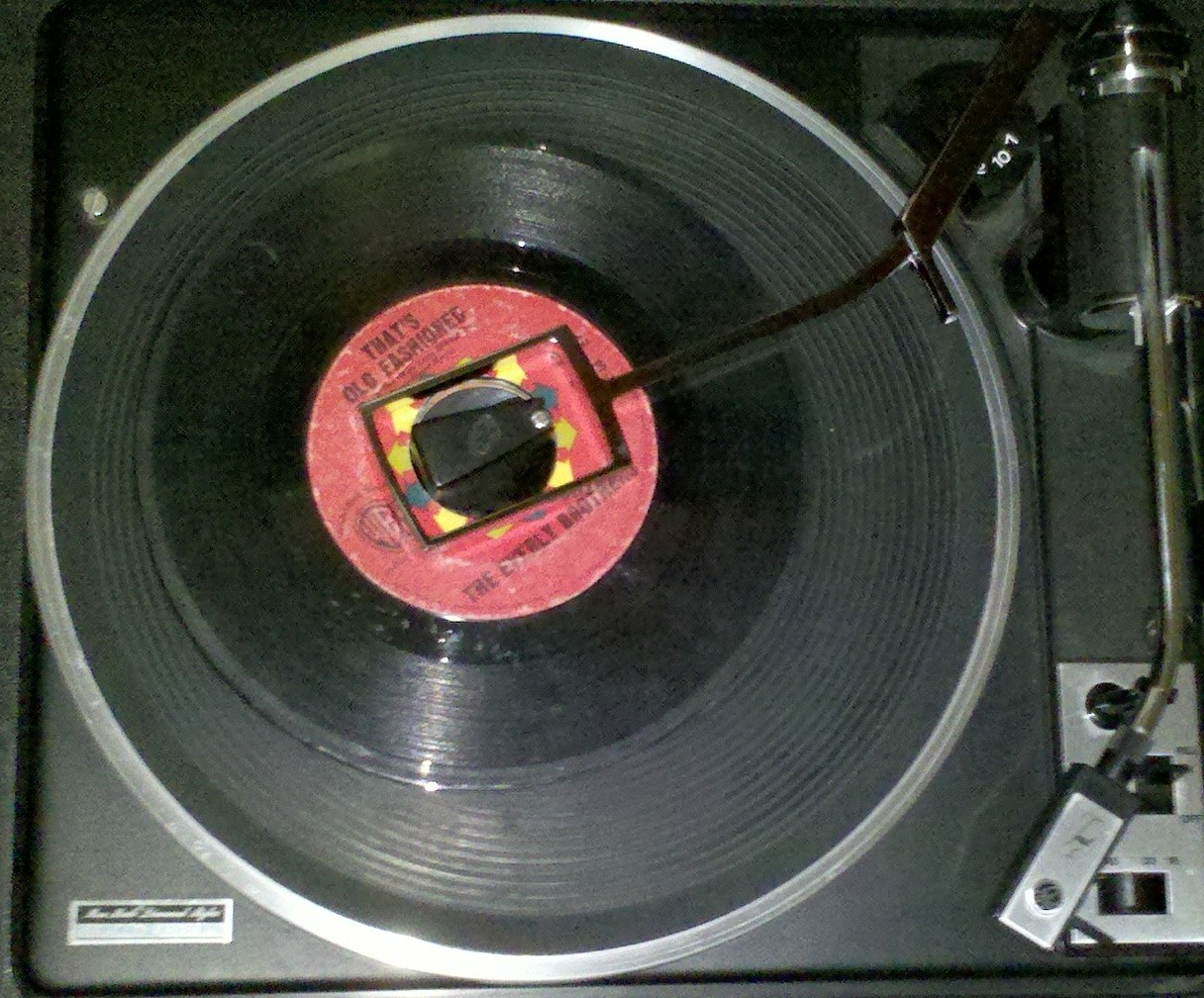

All functions of this player work except when the last record is dropped from the spindle the player shuts off without the record being played. Ideas?

by MattTech » Tue Oct 30, 2012 4:22 am
Likely the record support arm is bent upwards.
People pull on them by the end near the record, instead of properly lifting by the pivot at the rear.
This bends the arm upwards. - eventually leading to breakage of the arm.
Records should be level over the platter with the arm on them.

by elchucko » Wed Oct 31, 2012 1:38 am
Hi Matt,
I bent the support/follower arm up just a tad and it seems to be working better. Thanks!
