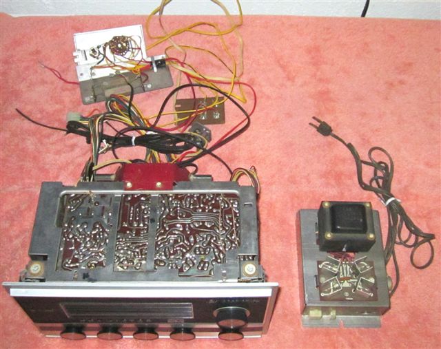

WANTED: RCA Receiver radio w/ power supply VHT52W
by audioman23 » Thu Nov 13, 2014 4:40 am
I need to acquire the receiver/radio with the power supply unit from a mid to late 60's RCA console stereo that someone has gutted. The model number of the console stereo that I have is a VHT52W, but I know that this receiver/radio/power supply was used in many other console model numbers. If someone here has one, it does not have to work 100%, but I would prefer one that did. Thanks
RCA Stereo Console Receiver with power supply
Re: WANTED: RCA Receiver radio w/ power supply VHT52W
by MattTech » Thu Nov 13, 2014 4:30 pm
That appears to be an RC-1223C radio chassis, along with the RK-314D power supply.
Missing from the photo is the power amp chassis, an RS-215J.
These three chassis were used in the model VHT52W.
