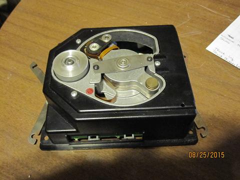

says nsm cd 100 near it on the player housing itself and on player is no markings defining what model it would be unless cd 100 explains it for you ....... AMI boxes i like much more stuff isnt so secretive and they are clear what things are and info is avail ...i can post a pic of the player if that would help let me know if youd like it in or out of the housing

Yes--post a photo--might be able to ID it-- Ron Rich

by mike11 » Wed Aug 26, 2015 3:25 am
heres a pic let me know what else you would need ..

by Ron Rich » Wed Aug 26, 2015 5:09 am
That's the first one--a CDM-3. Did you try carefully cleaning the lens, per instructions in the Service Manual ? If that does not help, find the DAC board (brown colored, with un-masked traces) and re-solder --ALL-- header pins and anything else that looks like a "cold solder joint"--Check that there are no plugs "heating up"--if so, replace, or, jump it--these boards were famous for poor soldering. Ron Rich
