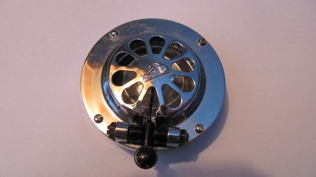

Beijar
Joined: Mon Jan 09, 2012 7:20 pm
Re: Reproducer repair question
by Beijar » Wed Jan 18, 2012 3:08 pm
I unscrewed the screws holding the needle bar (see picture) and then screwed them back, and it actually seems like the sound would be better now. I suppose it needs a little more fine tuning to sound good. Thank you!
