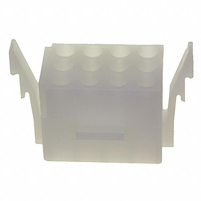

Yup! Note I said they LOOK like Molex, not ARE Molex. I know that the edge-connectors are AMPs (on the search unit, credit unit, etc), just wasn't sure about the square in-line ones. :) If these are AMPs as well (likely they are..!), I *believe* I found a match -
This is the socket, and would be the part mounted in the panel (on the cabinet for the stepper, coin switch plugs, or on the mech or power supply where the harnesses plug in.)
I'll order a set tomorrow, and test them. The trick with these is that they're not compatible with the newer 'standard' style, with the keying shape in the center of one side - the ones Rowe used had notched in the corner to prevent incorrect plugging (which didn't work too well, as you could still slide the other end on and potentially cause an issue..!)

And yeah - that one I have pictured above - notice it's keying feature is only on one thin side - flip it 180-degrees, and they'll stop that edge from plugging in, BUT - the other end will slide down, and potentially make pins contact each other that shouldn't be. (Essentially, sliding the plug on at an angle.)
