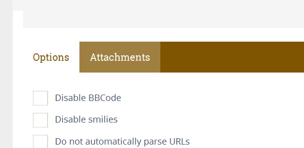

To Post a photo, scroll down to the area under where you type the text, and click on the Attachments tab --

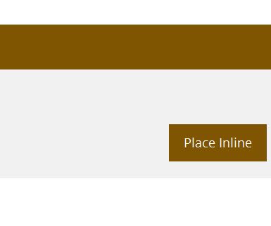

Then click the Place Inline Button
