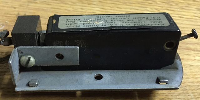

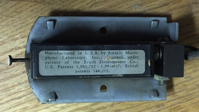

by Polaraligned » Wed Jan 20, 2016 1:22 pm
I have one in a Rockola B, and I assume that it is no good as I heard the crystal fails with age. (I currently am in the midst of a mechanical restoration)
What are my options for replacement?
I don't mind making a physical mounting modification to get the new cartridge installed, but I assume I will need a pre-amp with a newer cartridge as most have a lower output?
How about sound quality and record wear? Does a newer cartridge do OK?
I appreciate your time.
Scott

I can't find a seller above that sells a direct replacement.
NeedlesforJukeboxes.com told me that there is no direct replacement.
Google does not seem to help me locate a replacement.
What I did find is that West-Tech Services rebuilds these cartridges for $55 postpaid. Seems fairly reasonable.
http://www.west-techservices.com/p1.htm

Re: Replacing Astatic B cartridge
by MattTech » Thu Jan 21, 2016 7:34 am
Indeed, photos, or more information would help in replacement.

by Polaraligned » Thu Jan 21, 2016 1:39 pm
Indeed, I did state in my original post that it is from a Rockola B. This dates it at 1936.
I appreciate the help.
From what I have been able to gather, these have a 3 volt output, whereas newer ones have a much lower output.
I guess a preamp would work, but that is a hassle compared to just having the right cartridge.
I will probably try the rebuild route.
