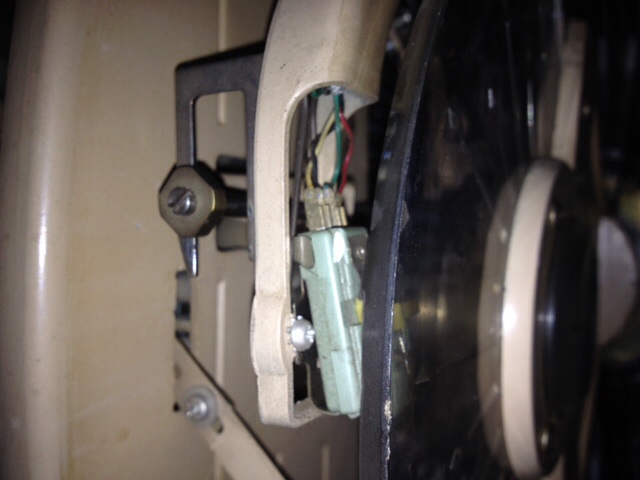

I have gotten my manuals for my 3300 but I don't see any instructions for replacing the cartridge. I ordered the P132 for it and I was told that there may need to be some soldering involved. Has anyone seen any instructions online or printed OR done this themselves? Thanks

Paul, you will need to solder new "flea clips" onto the existing wires. The original cart uses flat terminals and the one you've ordered uses the typical round ones. I believe they are included with the new cart.
FWIW: Going with the 132 is really a step down from even the original cart. The 132 is frankly, junk with a plastic stylus cantilever.
If you want to stay with a ceramic, the Tetrad P-404 with a fairly compliant metal cantilever would seem to be a good choice:
http://www.needles4turntables.com/ceramic.htm -Scroll down. I personally would not have known that Tetrad was still around, so I credit "Matt Tech" for the info.
I've restored 19 Wurlitzers from the carousel era ranging from 1700 through 3200. In all cases i went with a Pickering magnetic and added a slightly modded preamp.
The improvement in sound and tracking is dramatic and on a later arm such as the 3300 it really is no more complicated than fitting another ceramic. There is the added cost of a separate preamp but if the goal is to keep and really enjoy the machine I consider it well worth it.

Paul, if you've ordered the 132 you might as well install it and see how well it works for you. The procedure is exactly what a magnetic cart will require -minus the preamp.
The round clips are the same as a magnetic uses and you'll probably need to slightly rebalance the arm (simple adjustment) and perhaps a slight adjustment of the trip switch ans set-down settings.
If you later decide on a magnetic, adding a preamp simply involves plugging the two RCA plugs that go into the juke amp into the input on the preamp and the output of that into the amp.

Paul, to replace the cart the tonearm must be removed (obvious..right?). First unplug the pickup wire going to the back of the arch assembly.
Then set the mechanism to the play position w/out a record and shut off power. The arm assembly is held on with two Phillips screws...look underneath.
Carefully extract the arm assembly from the arch casting while noting how the pickup wires are dressed and the position of the cam lever and trip switch that touches the tail on the arm assembly...These have to go beck the same way.
A closeup pic might be helpful here.
When soldering the tiny wires do NOT solder them with the clips on the pickup. Use a gentle clamp or alligator clip to hold them.
As I mentioned earlier, some fine tuning of the arm will likely be needed after reassembly.
