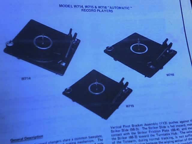

by Bobby Basham » Sat Jun 12, 2010 2:09 am
When you post, there is an option at the bottom of the screen to "Upload Attachment."
Click on Browse, which takes you back to your hard drive, select the pic, then "Add File." --BB
Maggie W714,W715,W716.jpg (24.84 KiB) Viewed 1138 times
