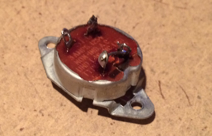

Thanks MattTech, this is very helpful. i've verified the bulb is correct, but upon further inspection, i noticed the print board where the wiring for the indicator light is connected is damaged. do you know where i can find a replacement board?
for the other issues, i inspected the multiplex switch as well and noticed the mechanical switch/power connection was also damaged. i've attached a picture. i'd rather not have to replace the entire switch if i don't have to. Any ideas on where to find a replacement part?

tjurek51 wrote:Thanks MattTech, this is very helpful. i've verified the bulb is correct, but upon further inspection, i noticed the print board where the wiring for the indicator light is connected is damaged. do you know where i can find a replacement board?
thanks again for all the help on this guys.
Nothing was mentioned about what R-chassis it is.
There are different series, with different configurations.
That switch has nothing to do with stereo multiplex, it's a power switch.
And after 50 years, boards and switches are certainly not stocked by magnavox anymore.
Best bet is scour the 'net for another matching chassis and hope for the best.
