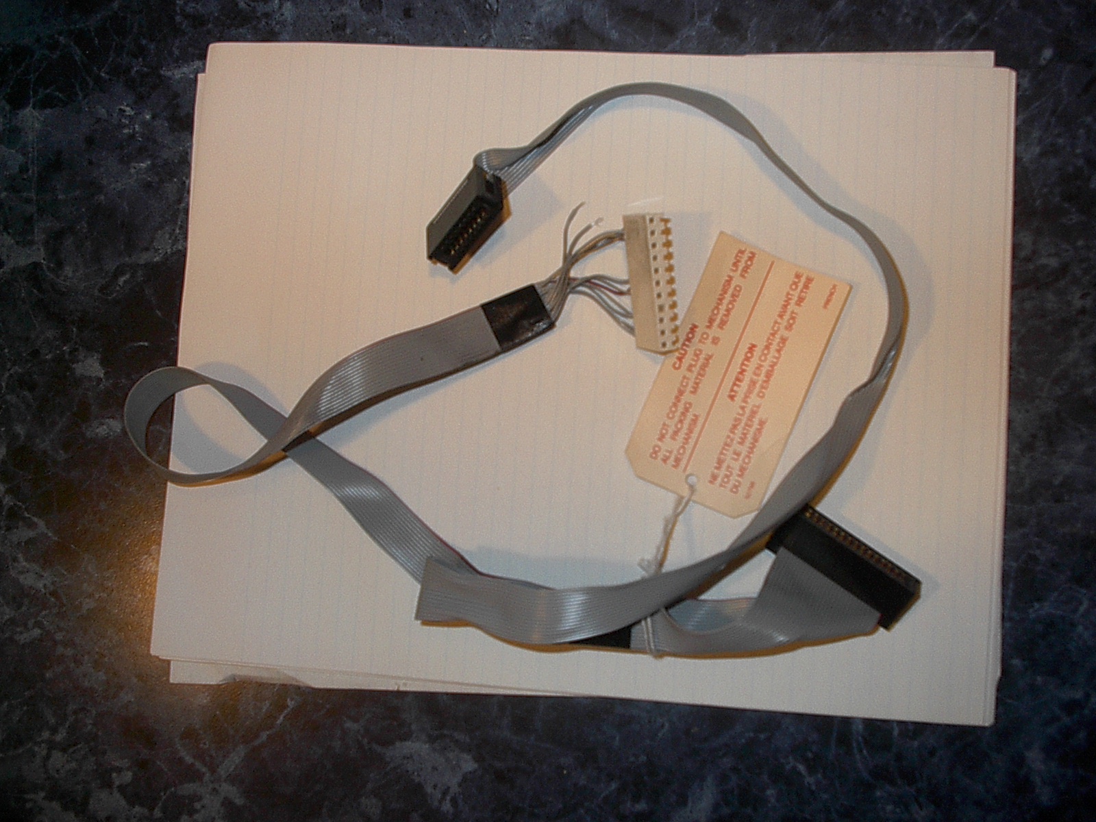

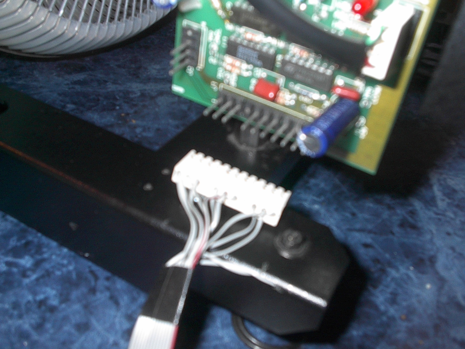

Ok, here are a couple of pictures!
The first shows the wiring harness with its three plugs: the cd player plug is the central white one (note the dangling wires!), the plug closest to that one is the 16 pin power source plug and the one with the warning label tied off near it is the 30 pin, P2 computer port plug.
The second, somewhat bleary picture is of the Rock-ola tagged CD player showing where the damaged J1 plug goes.
I have figured out where one loose wire goes (in the #8 terminal slot-a "scan" function), but the other is a mystery. It is a "power comm." wire and it HAS to piggy back on a terminal with another wire as all the terminals are occupied with the exception of the #4 terminal, which is blocked off.
Any help is GREATLY APPRECIATED!

Dale,
We have a winner!!
Going back to the schema, I found (at least on my copy) that you are referring to "Power Common", although mine only has one "m". This is the ground used for "power" voltages (+12VDC, 24VAC) as opposed to "logic" voltage (~+5VDC). This wire will tie into Pin 11 of P1 on your Mech Control PCB.
On this genre of Rock-Ola, the power supply used a center tap transformer for some of the "setup" (or primary) voltages. Especially the AC being delivered to the +5VDC circuit. For this reason, they may have "split" the grounds to reduce noise and adverse effects on the logic. I can tell you that this series has to have a properly phased and grounded 3 circuit outlet to work reliably. I have seen an ungrounded outlet cause the machine to remove credit, play wrong selections and cancel selections early.
