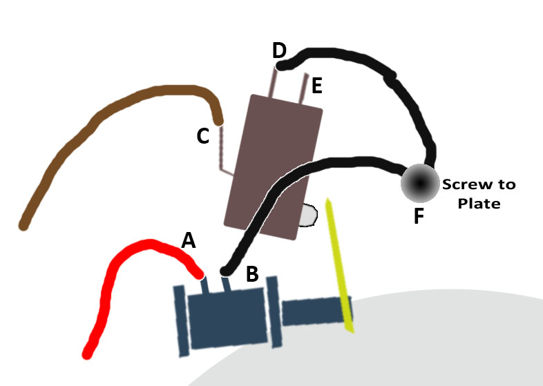

Just a quick one guys... Rockola 441 1969 model, the switch that gets pressed when the Wobble plate solenoid kicks in, does the switch use all 3 connectors. Mine just has 2 wires. Attached is a picture of the wires. Hope this helps.
The red wire attaches to the wobble plate solenoid (A), the Black wire from the solenoid (B) is screwed to the selector plate ground (F), the Brown wire fixes to the top of the switch (C) and there's only one Black wire attached to connector (D) which screws to ground (F). I have nothing attached to connector (E) on the switch.
Is that the correct wiring? If anyone has a similar Rockola I'd be so grateful if you'll let me know how yours is wired.

My GUESS would be that the COM and NO contacts should be the only ones needed for that function--it should be clearly marked on your schematic, and depending on the brand switch installed, on the side of that switch-- Ron Rich

Mark: the way you've drawn it is the way that switch is connected on both my 440 and 442, so it's probably right on your 441.
