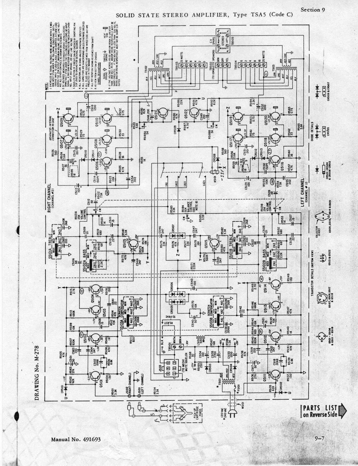

The problem here is the mute relay. It clamps the high side of the volume control in all modes except play. If AUX input to the amp is really desired I'd install a 120vac relay who contacts would open the mute relay coil circuit when the mech motor is at rest.
Input to the V.C will be 25K-ohms -a bit low for CD players but should be fine for MP3 players and most computers as they are designed to work into headphones. Level at that point is spec'ed at 0.075 -a bit low for line sources, but since it goes directly into the control it shouldn't be a problem. I don't know if the circuits preceding the control will have any loading or frequency response effect.

It's been years since I have added any inputs to an amp, but in my humble mind, it seems that the low side was "clamped"--not the high side --No schematic here today ?? Ron Rich
The closest I have is an schematic for a TSA-7 -too lazy to scan it. Here is a 5 from Vern Tisdale: http://www.verntisdale.com/schem/tsa5.jpg Same architecture. From my experience Seeburg and all the others always mute before the volume control.
